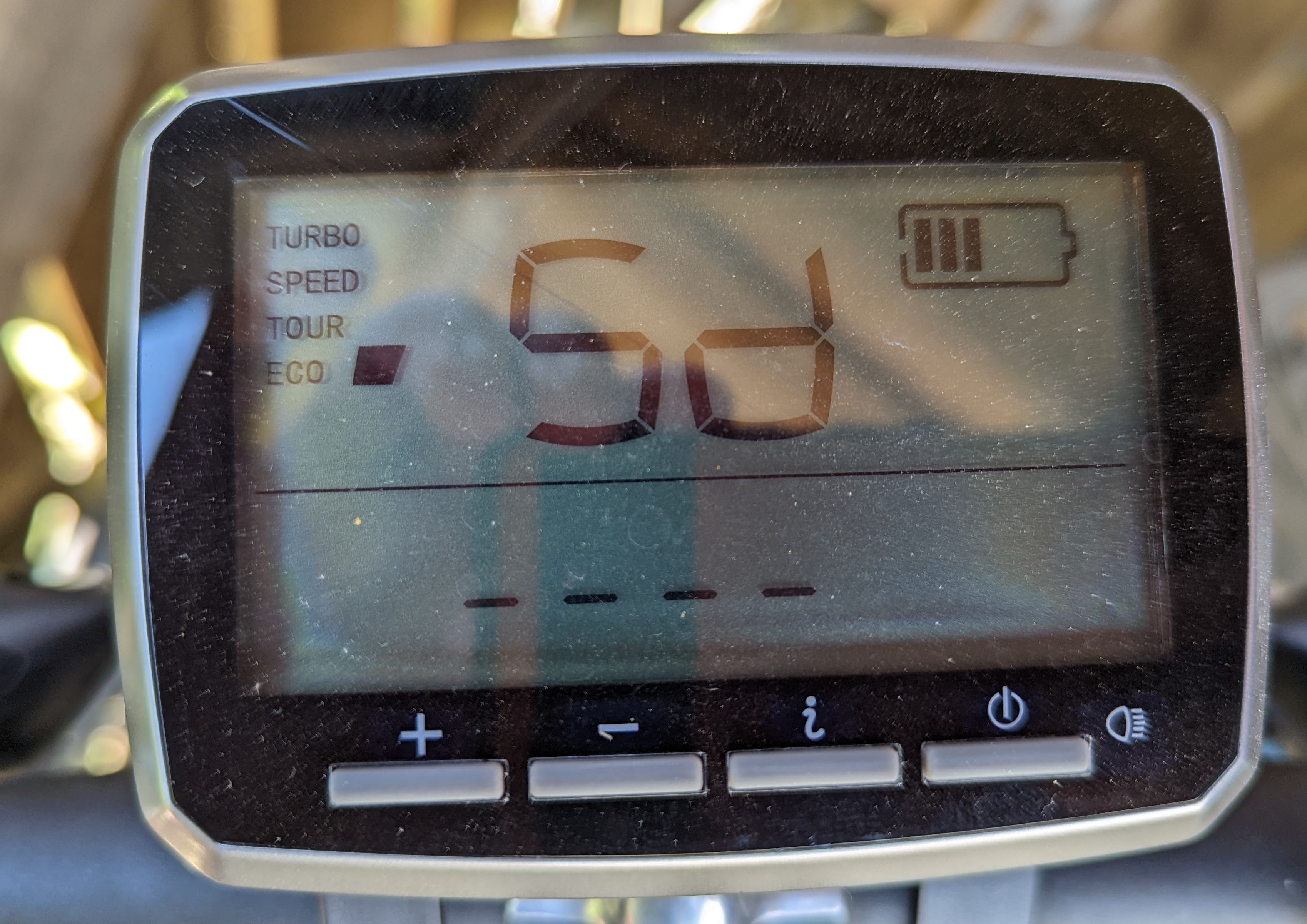

It seems like there are two Firmware versions for the new controller.
I have two new ones (both using VLCD5 Display FW 5.0), on the one Firmware i can set the speed limit to > 25 km/h and on the other i can't.
Doesn't matter which setting I use on the display (25 km/h on/off, increasing 25 limit to >25),the motor always turns off at 23-25 km/h...
Someone knows a way to port the one Firmware to the other Controller, so I can set higher speed limits?
Doesn't matter which setting I use on the display (25 km/h on/off, increasing 25 limit to >25),the motor always turns off at 23-25 km/h....
Just to be clear....
Which webshop you bought these new motors?
Can you change the speedlimit directly on the first one with just one setting?
Or is it needed to disable speedlimit fiirst.
Then change the limit to a higher value and enable the speedlimit again,
If so, this sequence doesn't work with the second motor?

I bought one controller on the ebay site of enerprof and one directly on their homepage.
Theres a few things i found out:
  • The ebay one has customizable speedlimits, i can change it directly in the "5d" setting from 25 to up to 45 and it works
  • The homepage one is not customizable at all. I can change the 5d setting to up to 60, but it does not do anything. Motor support stops at 23-25 km/h
  • The homepage one stops its motor support completely, if i turn the 25.0 km/h limit off
  • I can change the wheel diameter on the homepage one, but it does not do anything to the limit. It shows on the display the new speeds, but it stops at exactly the same speed as before.
  • The homepage one can not be changed from EUR to JAP
I strongly recommend anyone to buy the ebay one if you want the new controller!

This is not possible, as the 5d field can not be changed while the limit is off.
Testi said:
....This is not possible, ....
That's sad to hear this :(
It will be more and more a gamble what you get after ordering.
Last thing you can try is remove the magnet of the speedsensor.
imho the speedlimit is gone, but you haven't speed and distance anymore on display.
Same error for me with TSDZ2 v2.
I moved the magnet away so it had no function.
Now I get help over 25 km/h but the downside is that it doesn't show speed and odometer

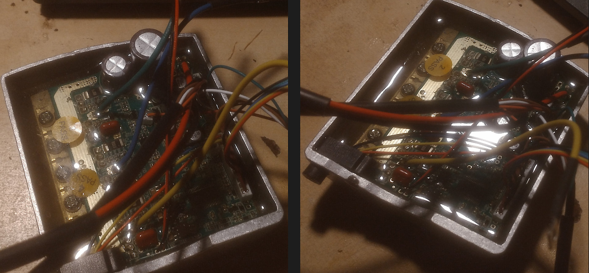

Does someone know how to dump the Firmware of the XMC based controller with J-Link?
I simply want to dump the Firmware from my controller Version without the 25 km/h limit and flash it to the other controller.
All i have is this J-Link clone:

Unfortunatelly not. I need to wait until my new J-Link arrives, as I accidentally shorted a smd from my last one.
But I will report my results as soon as I have tried to flash it.
