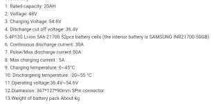

Hi! Thanks for sharing your experience — your firmware sounds really great!
Would it be possible for you to also compile a .hex version for a Rated capacity: 20AH, Voltage: 48V, Charging Voltage: 54.6V, Discharge cut off voltage: 36.4V, Continuous discharge current: 30A
battery and upload it to Dropbox? I’d love to test it on my setup.
Also, one more question:
Will your settings work with the B02N display (I believe it’s the same as EKD01)?
Thanks in advance! :)
Hi, there is no need to compile a hex for a specific setup. You have to create you own setup using the Java Configuration Tool. That is what everyone, except for the 860c users, has to do either way. :)
I am not sure if anyone tested the B02N yet, but it will most likely work because it is the same hardware as the EDK01.
