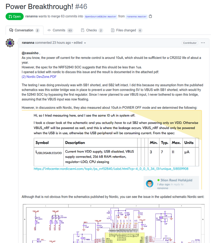

Wireless remote battery will work for 2 years
@rananna is doing a great job on the wireless remote and was able to optimize the power, and considering a regular usage (even with LEDs blinking), the battery will probably work for more than 2 years:
Here is a link to the pull request for those that want to read it:
https://github.com/OpenSourceEBike/ebike_wireless_remote/pull/46
