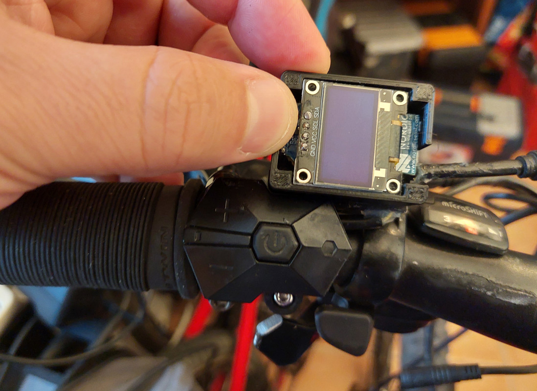

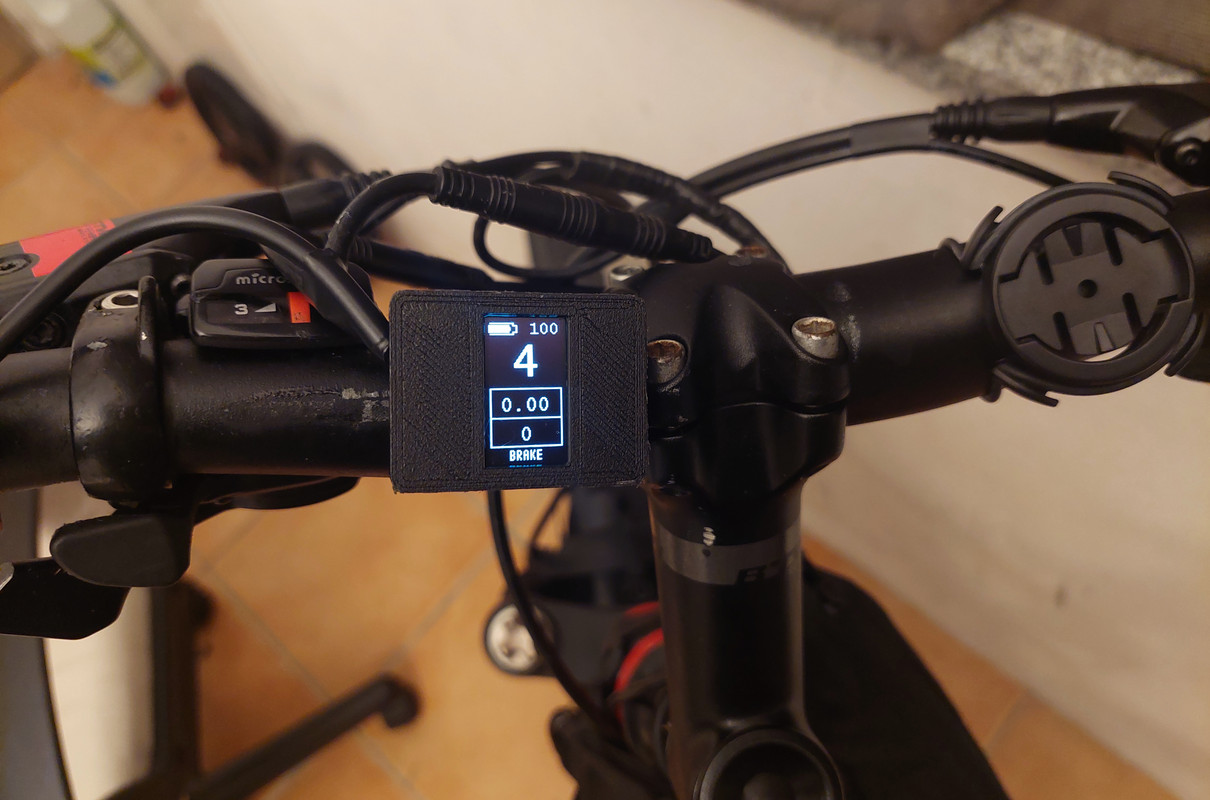

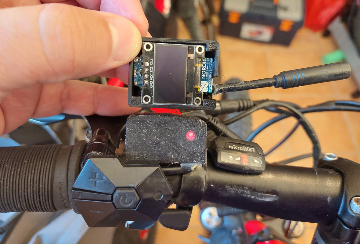

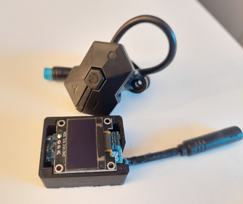

The small oled display arrived and I quick adapted the enclosure to hold it. Soon I will started the firmware.

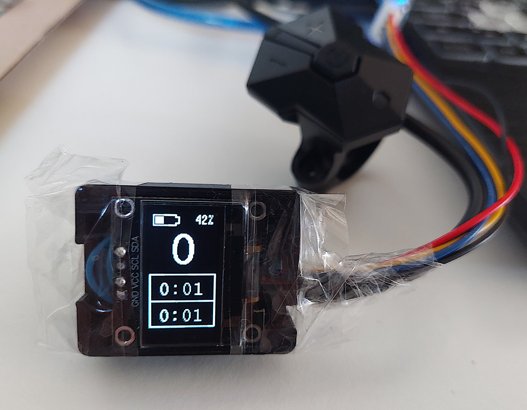

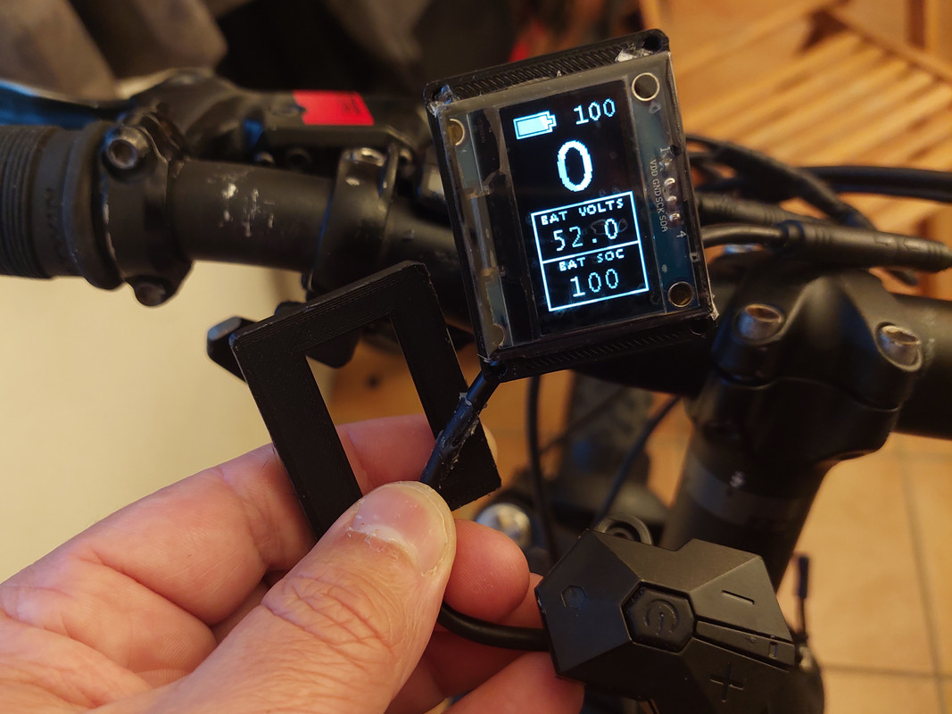

Almost there to have our screens working. The display fully works:
Firmware: https://github.com/OpenSourceEBike/ev_display_bluetooth_ant
So the display and buttons do work well. This version of display uses I2C communications which is slower than the display version on SW102 that uses SPI, and so I see a noticeable delay when changing the page as full screen is redraw - maybe I will test later with display version with SPI.
I am using a display that has the same pixel resolution than SW102 but it is smaller. The battery SOC letter are to much tiny to be readable while riding so later I need to increase that size and probable change the layout.
I am still thinking this is the TSDZ2 wireless controller with wired remote and a display. I hope it will also work without the display and the buttons, using just the same firmware as TSDZ2 wireless controller:
Here is a video of the display working on my EBike with TSDZ2 motor - it was quick, thanks to the usage as the same hardware as the wireless controller and the SW102 firmware.
I started the firmware using the wireless controller firmware and only after I added the display firmware, so this display works with th mobile app as also ANT+ LEV ebike and the ANT remote:
[youtube]viimR74NPZk[/youtube]
I did the 3D printing enclosure in a way it fix to the handlebar in a similar way of the Garmin GPS displays, using the elastic, so should be easy to fix on any handlebar position.
On the bottom there are 4 small screws on the corners, to easily open in the case of needed repair:

Maybe that is the one I trashed while opening to flash the bootloader firmware. I really like SW102 for his size... this DIY display is much bigger, there is no way to make something so compact in a DIY way. On the other side, the buttons on the SW102 are bad, lack of tactile feedback and the buttons are to small, here our display has much better buttons. And most importantly, it can be repaired and adapted for different systems, like adding CANBUS communication instead of UART or any other thing, like for Xiaomi scooters is a different UART type, only 1 wire UART - SW102 would never work.
Also this display still integrates with the Garmin displays or others, using the ANT+ LEV Ebike wireless profile. And I hope all this work in a way that user can simple no connect the 4 wires display and have the regular wireless controller.

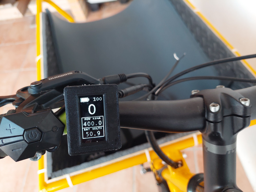

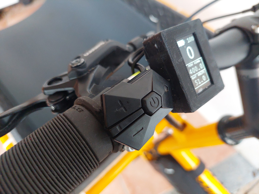

Now I need to find a way to make the display water prof. The main issue is on the OLED glass. On SW103 there is a thick transparent plastic alike if is a glass. I do not know how to get that kind of plastic sheet for DIY and how to apply on this design.
So after trying to use the TSDZ2 fully wireless remote, I found some issues that are not possible to solve:
- moderate effort to check if the motor is on and ready: it needs a click on the buttons at least, as there is no always on LED to conserve the battery power
- very hard to see what is the battery SOC: counting the blink pulses of the LED to see the SOC is very limited, I feel a frustration
I really missed a small display as SW102, where I can quickly see if the motor is on and ready. It is crucial for me to check the battery SOC as also double check the battery voltage. Then I also miss to see the motor power, to understand how fast I am using the battery and if am using the motor at 50% of his capacity or such.
So I decided to buy a SW102 to install on my shared cargo bike with my wife. Then I did destroy it because they changed the hardware and so finally I decided to build my own display, based on the TSDZ2 wireless controller with wired remote and added an extra OLED that needs only more 4 wires connected.
I started to prototype using an OLED display of 0.96 inches (smaller than SW102 display) but I ended with OLED display 1.3 inches, just the same size as SW102 display:
I already installed 2 of this displays and they are working well. I am in the process to solved some small issues and make a stable release, maybe in next 1 or 2 weeks. So I decided to stop working on the TSDZ2 wireless and the natural continuation is this display, that includes TSDZ2 wireless + wired remote + OLED display. I did not removed the Bluetooth or ANT code but I simple disabled it as I would need to update them and the mobile app, which is something is not a priority for me as I decided to keep the configurations on the display.
