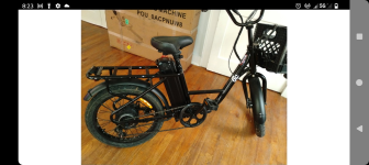

I spoke with him last night and he's actually looking for more of a dramatic increase in speed. Here is the bike

That's a dumb looking bike for going past 30 mph. I hope it's a steel frame. Silverfish battery? YOu can get them in higher voltages, but a different case may have some advantages.
You must have a 52V battery in your parts bin. Just splice it into the harness and go for a test ride. That will give him a 14/13 gain in speed. Then he can judge if it's worth buying a battery and controller.
I suspect that if you install a 1000W DD motor in the back, you might get the speed. Smaller 20" wheel might hamper it, People install those cheapo Voilamarts on beater 26" bikes and claim to go over 30 mph.

Not worth upgrading. If the battery could handle a 20A controller, and you find a motor that has a kV rating close to 13 or so, he can get close, but that assumes 100W of pedaling, which he can't do with the big rear cog and not enough chainring and a 20" wheel. Any controller upgrade would have to be mounted on the frame, since the small oven the stock one is housed in will just cook a controller that's bigger than the one he has.
If he wants a fast bike, tell him to get a fast bike next time. Any bike that's slow with pedals only, will be slow with a low powered electric motor like that. Terrible bikes don't somehow become good when you motorize them.

Even for the originally stated 30mph, you'd need a new battery, controller/display, probably new motor, almost certainly new brakes, possibly tires, etc.
For "dramatically" more than 30mph, I don't think it'd be safe with that bike regardless of upgrades. (well, I don't think 30mph would be safe on it either, but...)
