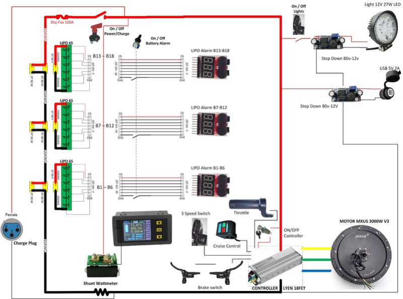

Here a schematic of my future ebike vector with MXSUS V3, Lyen 18FET, 3x LIPO multistar 6S 20AH (cabling ready for 6S2P), front led light 27W and USB plug
No BMS, just lipo alarm with switch to avoid discharge. Charge on ebike with 48v powersupply and DC StepUP 1200w to adjust 73.8v (4.1v /cell)
Wattmeter and all informations (discharge and charge current)
Charge at home each 10 discharge cycle with R/C charger.
Where did you get the 80v to 12v dc-dc converters?
lionelt
Aug 20, 2015
31
FR Haute Savoie (Alps)
DasDouble
