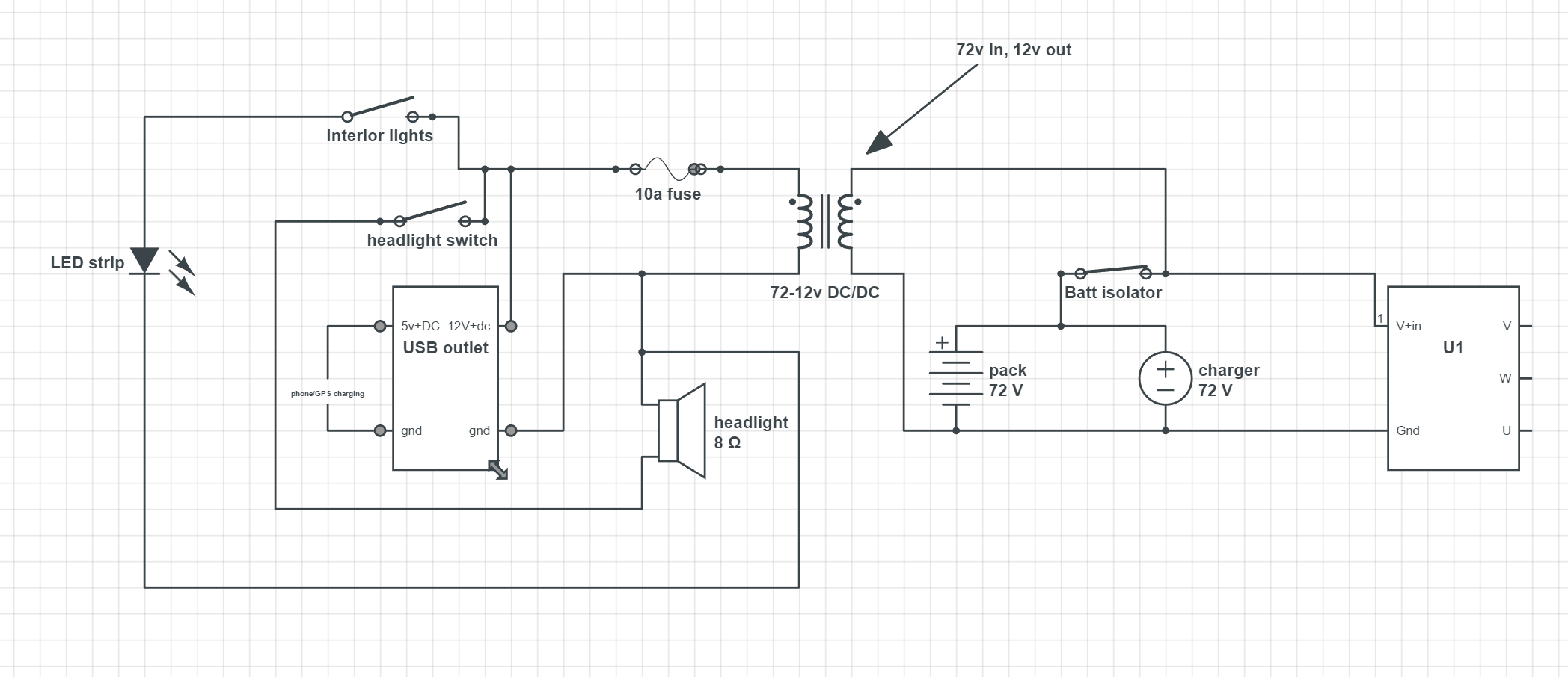

can you guys just verify my design for a pack-fed 12v side? I also plan on keeping the charger inboard to allow for onboard charging. The battery is a 72v 20ah pack with an embedded BMS, and the charger is the one that comes with the battery.
Looks good to me.
The battery isolator switch will sort of take a beating when turning on as the capacitors in the controller charge. I've seen people use circuit breakers made for solar systems that seem to work well for this.
