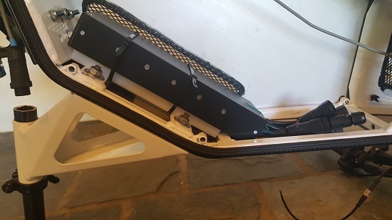

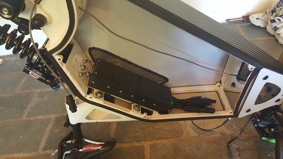

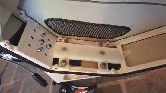

I drilled some holes then I ran an 8mm tap through them this will allow me to mount a plate that will hold the max e in position
I then bolted the 15mm thick piece of plastic plate into position using 8mm stainless steel countersink bolts
I will use some double sided tape and cable ties to secure the max e
It fits
Baby steps
I will get there one day :)
