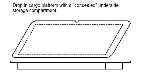

Also my thinking is with the side platforms I can make some nice wood platforms that have a compartment on the underside that's a few inches deep which can hold battery packs or chargers, maybe tools or parts... I don't know yet but I'll think of some way to make a couple of pseudo trunks. :D
This is what I'm thinking of doing... sorry no fancy renders, just some paintCAD
