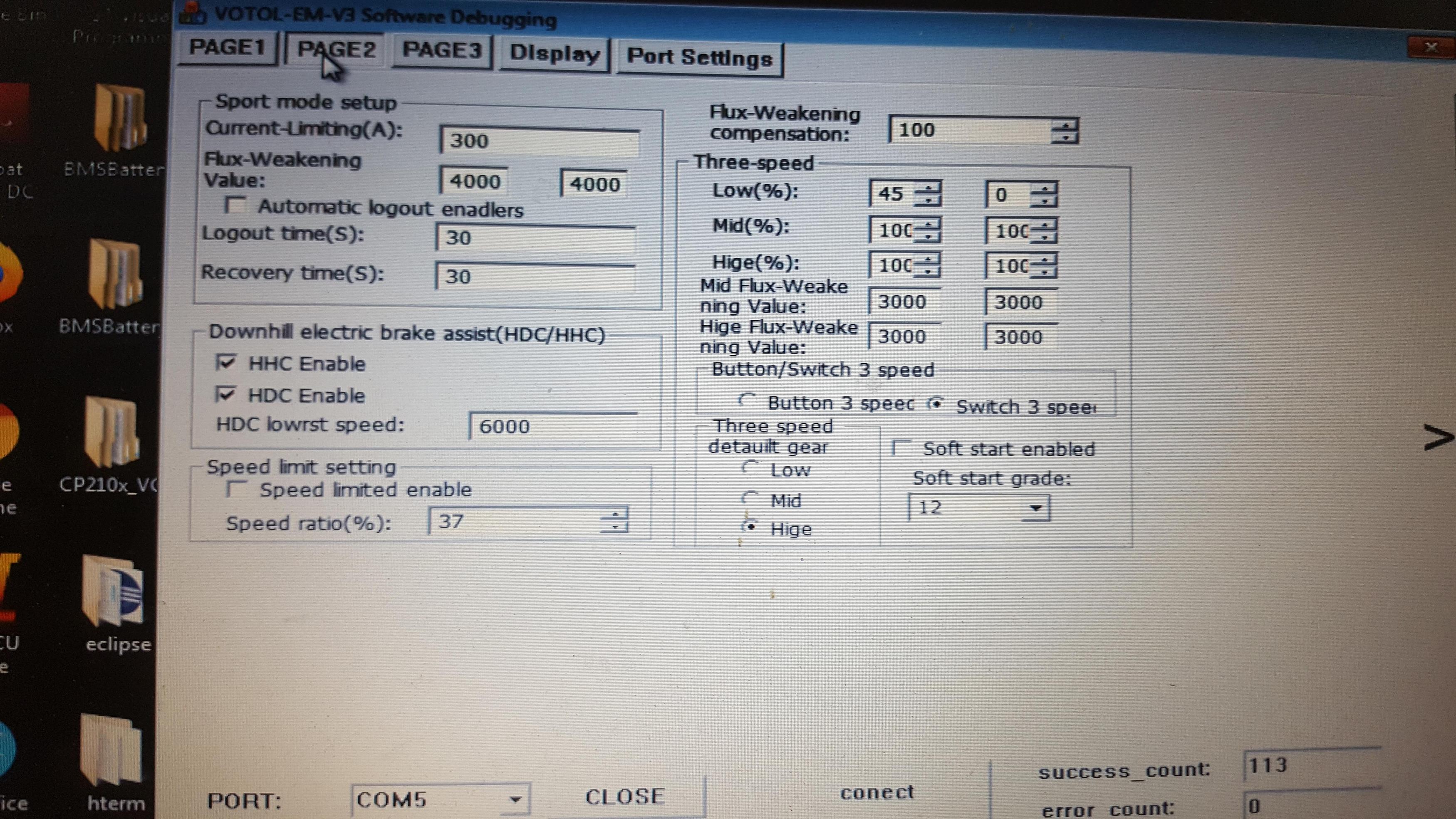

Has anyone played with engine braking when you release the throttle?
I have tried both HHC and HDC:
None of them seems to do anything.
In the manual it says "HDC lowrst speed" sets how low HDC should be active.
400 should be about 15km/h. I tried 300, but then it jerk on throttle. It seems more like an rpm limit.
I want something like an ice engine when you release the throttle.
