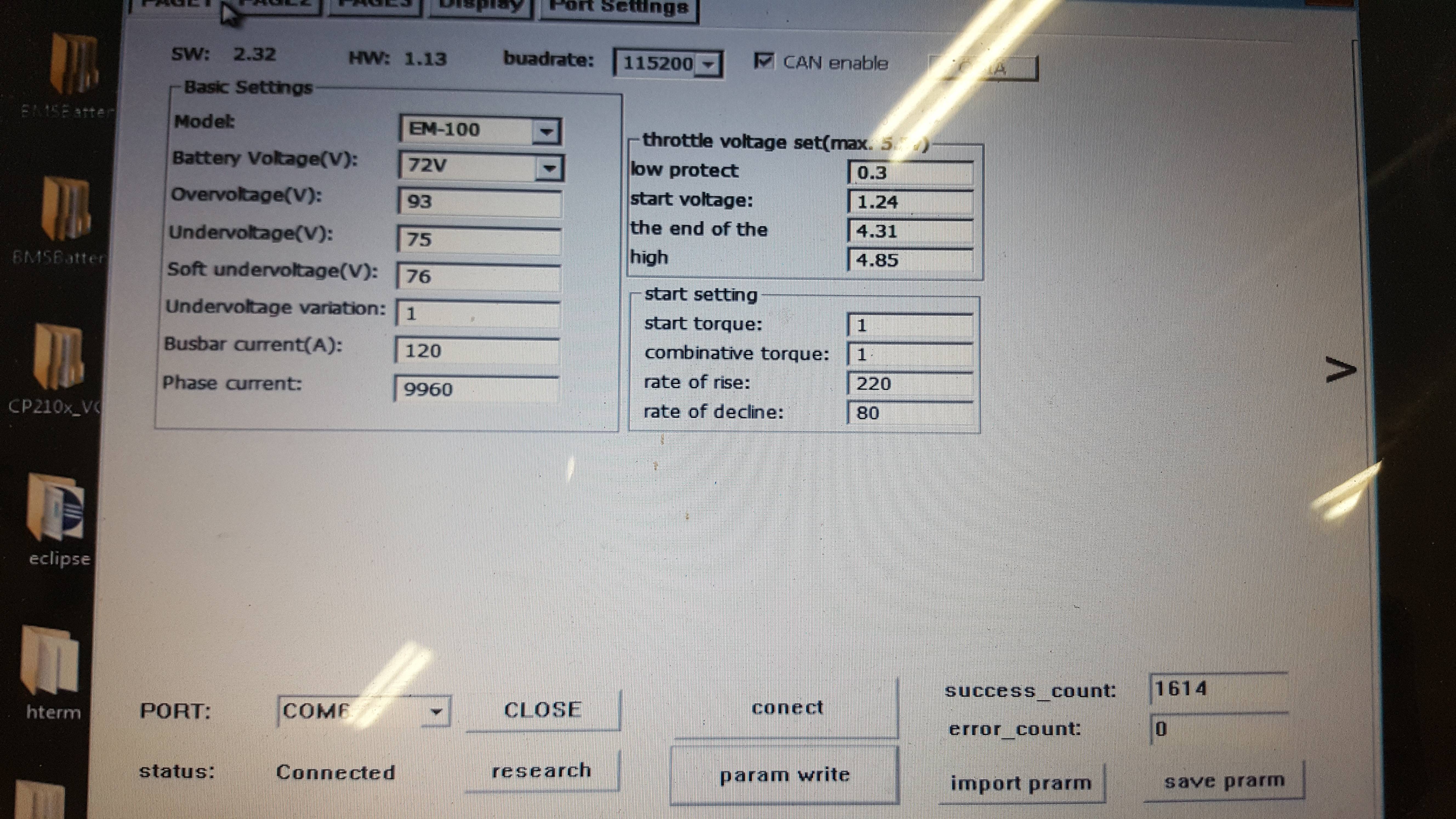

It seemed to work fine, I had throttle, I had regen. I turned it on and tried an earlier sw that shows settings for motor temp. I had some connection problems at first, but then it worked. I had strange settings for motor temp, but didn't change anything.
I then connected to the newer sw again, and this is what I get:
The controller gets 81v. I have no reaction to throttle. If I unplug throttle or motor halls I get a fault for that. If I spin the wheel by hand I get rpm.
I have tried to write the same parameters again to the controller, it worked but didn't do any difference.
My settings:
It has some strange settings for FW, but that is how it came.
Any idea what to do?
Edit, Luckily I had saved the parameters it came with. I could load that again, and it worked again.
No idea why :roll:
It feels like a real stable controller :confused:
I had the same issues in my first controller, seems program is not stable in saving/updating, sometimes rendering it corrupt?
Johnnydrive got it fixed when switching to different SW so that could be a fix.

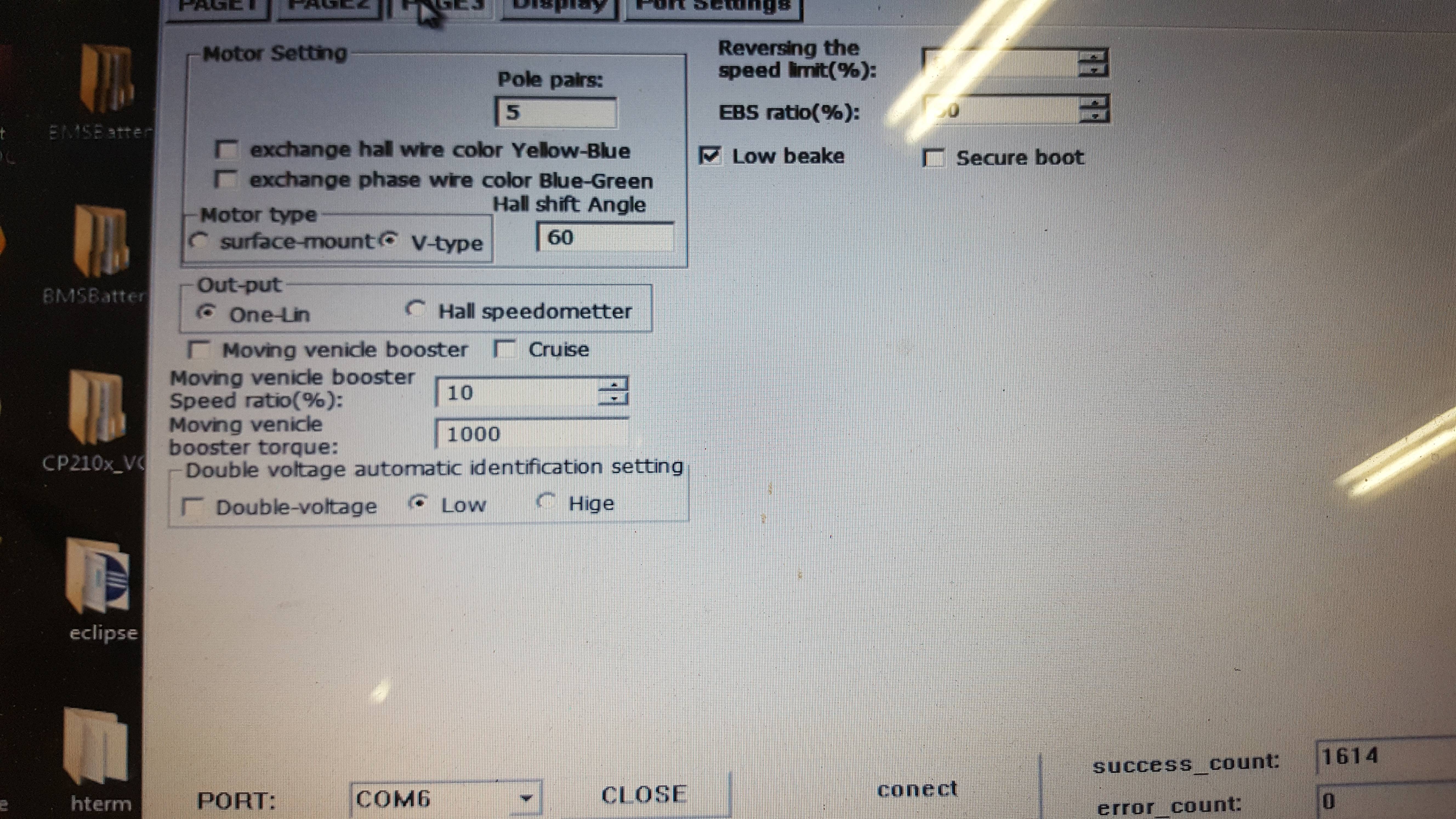

Hello guys
I want to ask if anyone understands how to activate the cruise control. I've definitely needed it lately. :D
I've tried everything so far and failed.
I guess it should be activated on page 4 but also on page 5 - port setting.
I have no idea but I want to use this service
What you see in the pictures, port 4 and 5 are free for me, but I use the port for my speeds, so I have 4 ports (One klick Repair) left free, but how to activate it for cruise control, I have no idea if it's even possible.

Then I would look in PC15, in the roll down menu and see if i could find something about cruise. Then my guess is to mark SW to be able to use a button on port 4. No idea if it works, but might be worth a try.
Just to make sure, you have tried to mark cruise on page 3 and keep the throttle stable?
