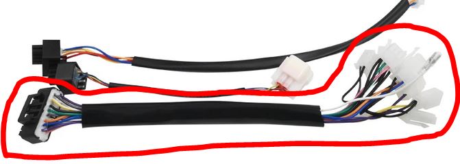

CAUTION! I requested the VOTOL setup (XYT signal), but I got something completely different. In my case, the black/red cable was not like in the description the XYT signal cable, but was connected for the low beam. I had to solder the purple wire from "Speed" to HL. But then it was working fine. Reading other reviews, other people had the same issues, so open up that thing before you connect it to your bike

Does anyone know where i can buy this cable alone? Its for EM-100
