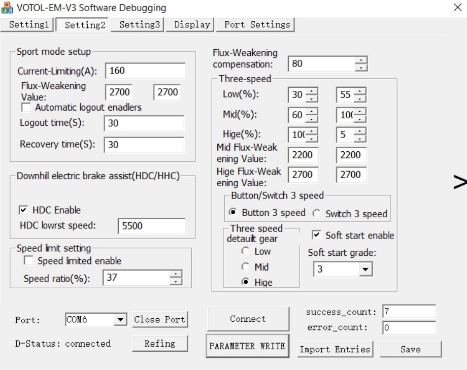

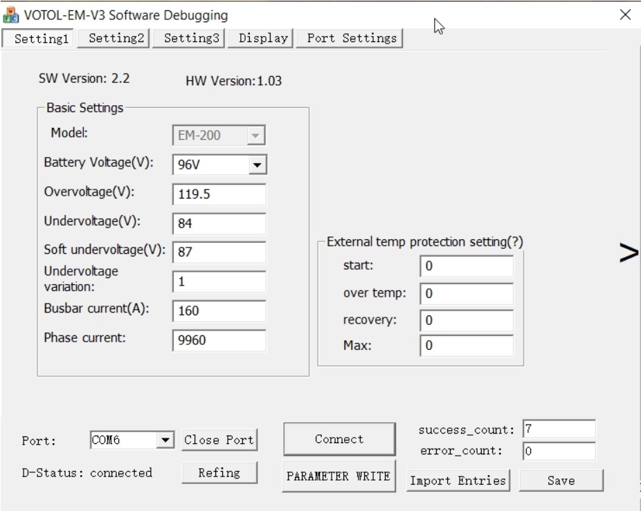

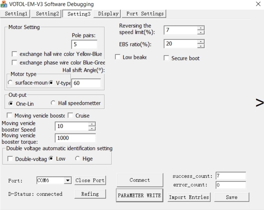

I have posted them a few times in the thread, but here you go:
I have made some small changes since those pictures were taken, but this is basically it.
These settings probably dont work on the newer controllers (sw and hw version on page one)
It seems like flux-weakening compensation on page 2 is not the same thing, and the box to the right on flux-wekening in sport mode is used to tune the motor. Maybe the box to the right on the other flux-w settings too. But there are some info on that on the last few pages.
I reach at least 8000 rpm with these settings.

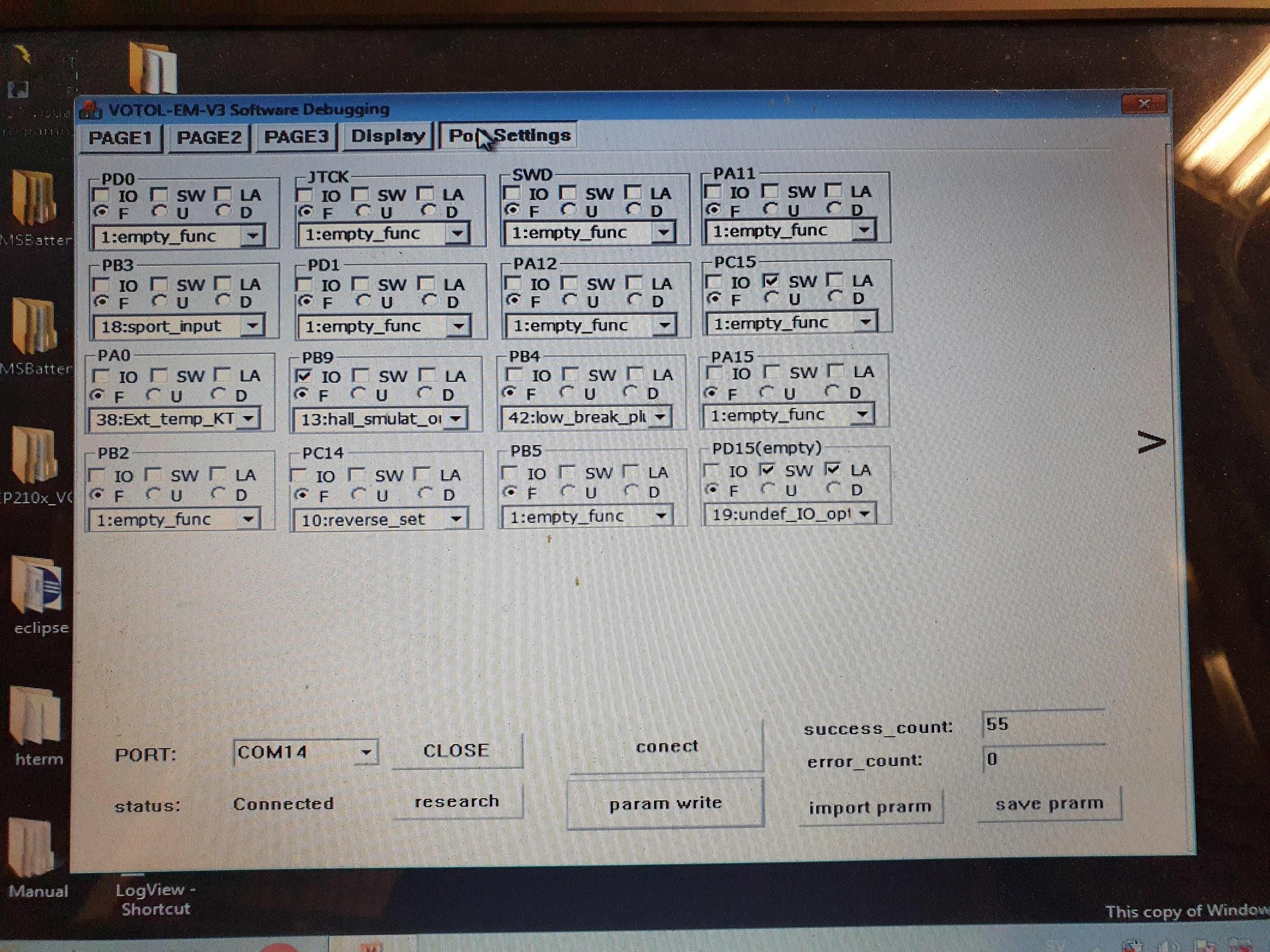

Thanks for your suggestions. I had major problem with the hall shift angle on page 3. Now the motor is working fine and smooth.
But I still don't understand how the ports are mapped in page 'port setting'. I figured out that the PA0 is the pin 5 of hall connector. as shown in figure. could you provide me a proper port mapping to those pins in the connector.
