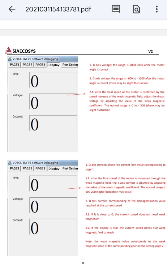

Hi All,
I'm just playing with the flux weakening and jitter values, and found one page in the manual:
It says at this display it can show the Q and D axis voltages and currents to help to find the best flux weakening values.
How can it be activated in the software? How can i find the best parameters for the motor? Is there a good description somewhere?
The motor is qs138 90h, and the controller is em-200SP.
(I found that with 150 jitter settings it starts to move smoother than the original 1000 setting)
Tapatalkkal küldve az én Redmi Note 8T eszközömről
