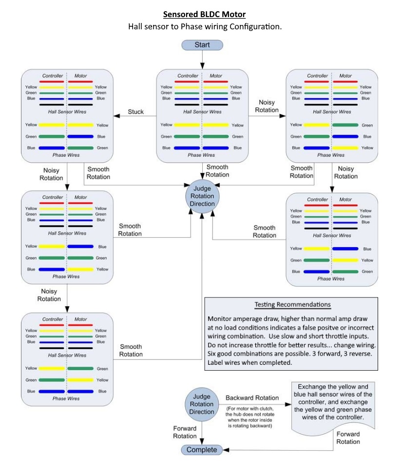

If you're sure your throttle is wired in the correct order to match the controller (5V, ground, signal), then you may need to swap phase wires (motor is "stuck").
How do you mean "stuck"? It turns when auto learn is initiated. It goes half a turn one way, than half a turn the other way all on it's own.

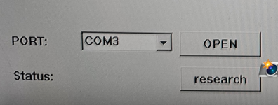

Hey, I dont think youre actually connected to your controller, in your case it just says "OPEN"
meanwhile if you were properly connected that open option should instead read "Close Port"
You should also be getting a voltage reading and if anythings wrong/misconfigurated, possibly a fault code in the display tab.
Sorry for misleading you, but I took the screenshot of the saved configuration, while taking the photo I was at work and not conected, but those are the correct values. Still don't understand why I don't see a voltage reading, but there is no faults registered at all.
