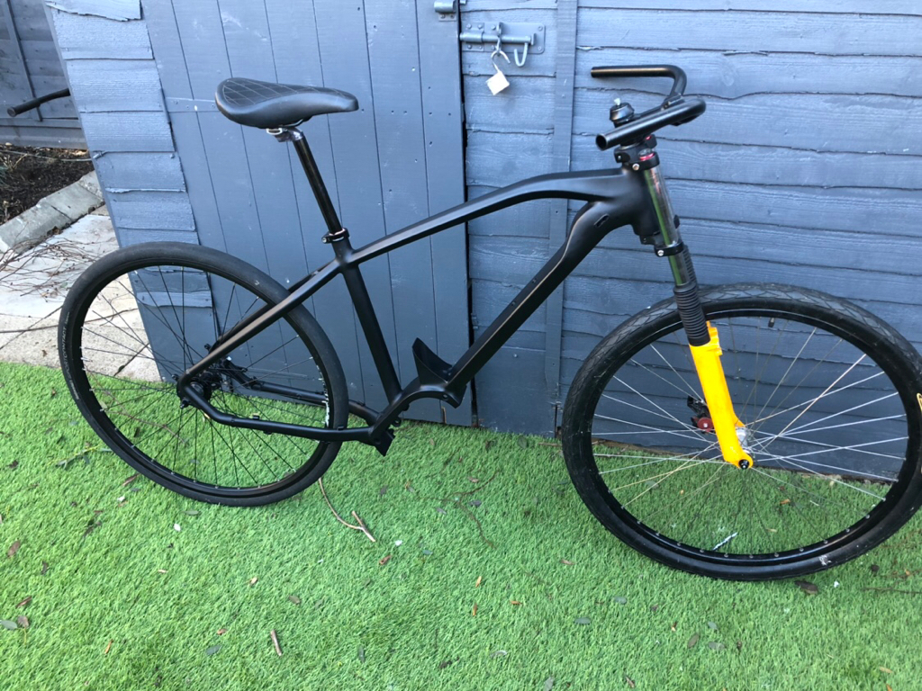

Hi everyone
Just wanted to say that my bike is 90% ready.
Thanks you all for the help, specially Wayne.
The bike runs smooth.. 40km/h on a flat.
The geometry is very nice and fits for my trail use.
The build was a hard thing to do.. Any new ones who approach it should understand bike mech.
Vividguy said:
Hi everyone
There are a lot of lurkers (interested parties) on this thread like me. :) If you could provide some build details battery, components, etc. it would be appreciated. Problems you had. Pictures too.
1. Fox 34 150mm fork,fox preformane 51/200mm on the rear.
2. custom 48V 12ma Battery without that strange com. protocol.
3.running 1*9 shiftter shimano alivio , cassate 11-42 sunrace.
4.Bafang M600 mid drive, magura MT5 180mm rotor.
about the build it's you on your own, there specific tools like locking ring tool that no one haves.
the installation of the engine took a while because the frame motor housing didn't fit ...sand scarpt it
a lot of fitting adj. on the rear susp. and other stuff.
It's not a job for beginners, I wish everyone good luck and I will keep posting
