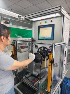

We test every DM motor individually.
We don’t rely on batch sampling. Each production motor is hooked up to a test bench before it’s packed.
The goal is straightforward: make sure the motor, controller, sensors, and communication system all work together properly before anyone installs it.

3. Torque Sensor Calibration
The torque sensor has a big impact on how the bike actually feels to ride.
Because the torque sensor determines how natural the bike feels to ride, it's one of the last systems we calibrate before final inspection. We check:
- Zero torque value is correct
- Sensor output is stable
- Signal changes smoothly under load
- No abnormal drift or fluctuation

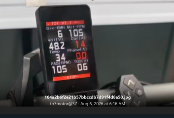

4. Dynamic Motor Run Test
During production testing, the motor is operated through multiple speed and load conditions to verify consistent behavior before shipment.
We monitor:
- Rotation
- Speed response
- Current draw
- Phase balance
- Controller behavior

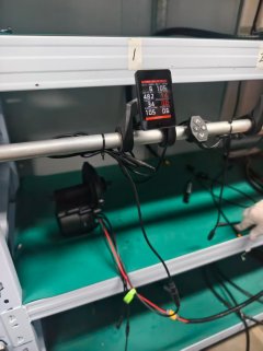

6. Communication Verification
E-bike systems rely on smooth communication between components.
Before shipping, we test the motor with supported displays to confirm:
- Startup works normally
- Parameters transmit correctly
- Errors report as expected
- Assist operation responds properly
