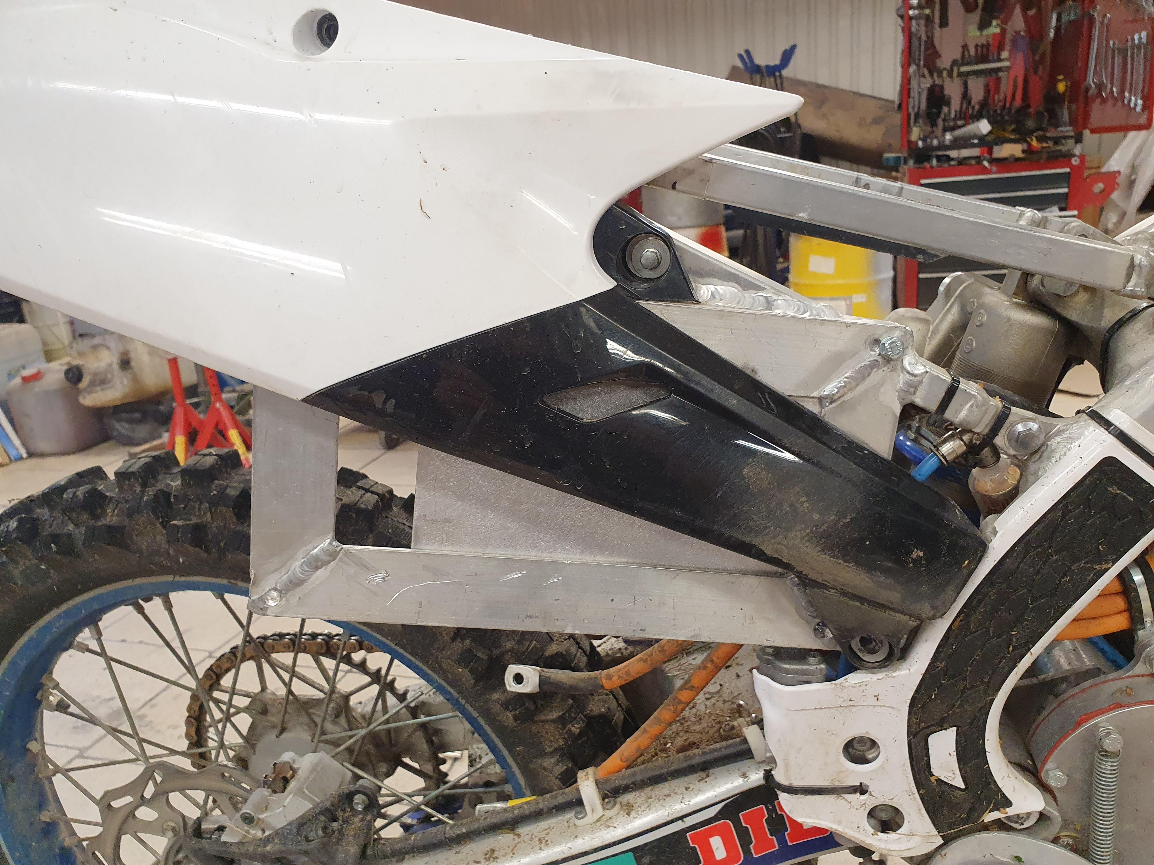

It is even more obvious when mounting it on the bike:
The plan was to just drill some new holes, that way I could easily change controllers back and forth.
But I will have to change the bracket, I can shave off a good 75mm of the length and maybe 15mm in the height.
The length that sticks out behind the fender is about halved :D
I was a little worried about the placement of the connector. But with the controller being so (relatively) small, it will be covered nicely by the fender.

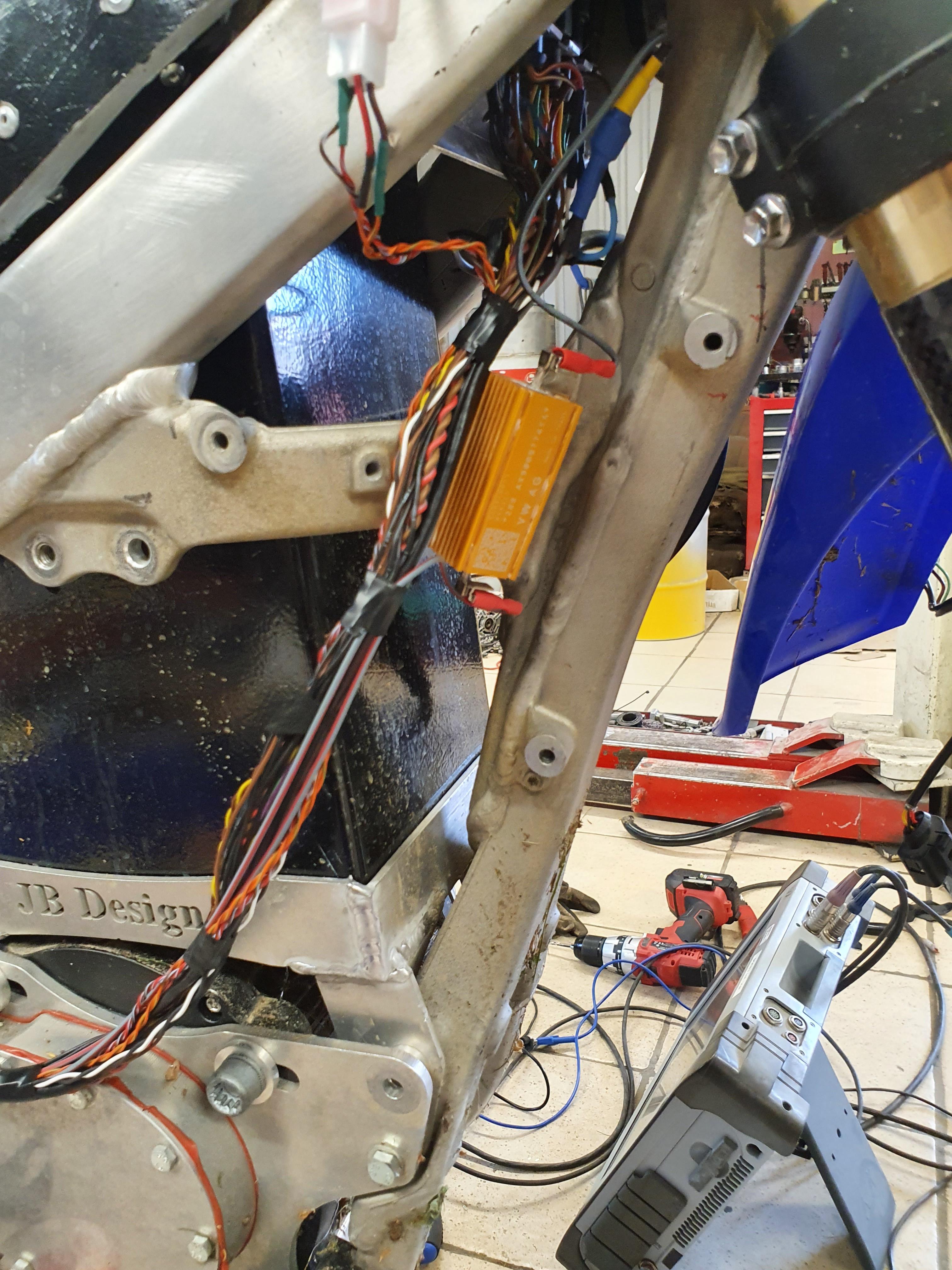

I just connected the key switch wire to B+
But I have a pre charge problem now..
Sevcon had its own pre charge and contactor control, so I didnt have to worry about it.
I tried to keep the electrical system simple, and didnt have a 12v system at all.
I had an idea for a simple pre charge system with a resistor and a 12v converter in parallel.
Here is the converter I am using.
And pre charge resistor.
I have a built in relay in the batteries that i control on the negative side with a switch, because I dont want hi voltage at the switches.
When that relay turns on both the resistor and converter gets power at the same time. It takes about 0.7-0.8 seconds for the converter to power up and switch on the contactors, and during that time the controller gets pre charged.
With the contactors disconnected from the controller it looks like this:
The yellow line is the voltage on the controller, the green is output from the contactors.
That the voltage is climbing a little on the contactors before they close is probably just some interference, as there is nothing pulling the voltage down.
As you can see, there is about a 20v difference when the contactors close. I dont know if that is good or bad.
The problem now is that my small relay in the battery dont seem to handle the pre charge current very well :(
I am thinking that it might work if I use a second relay or something, that turns on a little after the one in the battery.
It would still have to take the load, but it wouldnt have to switch under load.
That could be controlled by the 12v converter, but then I would loose my "ghetto pre charge timer"

I had a problem with my circuit that I didnt think about at first.
When everything is on, and I turned off the ignition the relay that supply power to the 12v converter and pre charge resistor turns off.
But the resistor is connected to B+ on the controller, and then supply power from B+ to the output on the relay. That means it also supplies power to the 12v converter, and that keeps the contactors on..
I disconnected the resistor to turn off, then forgot about it. Turned on without pre charge, then I culdnt turn off. Everything turned off as it should, but the contactor(s) stays on :(
I tried turning them on and off a bunch of times without load, also tried hitting the battery with a plastic hammer. So far no luck.
A diode in series with the resistor solved turn off problem, but not the welded contactor..
