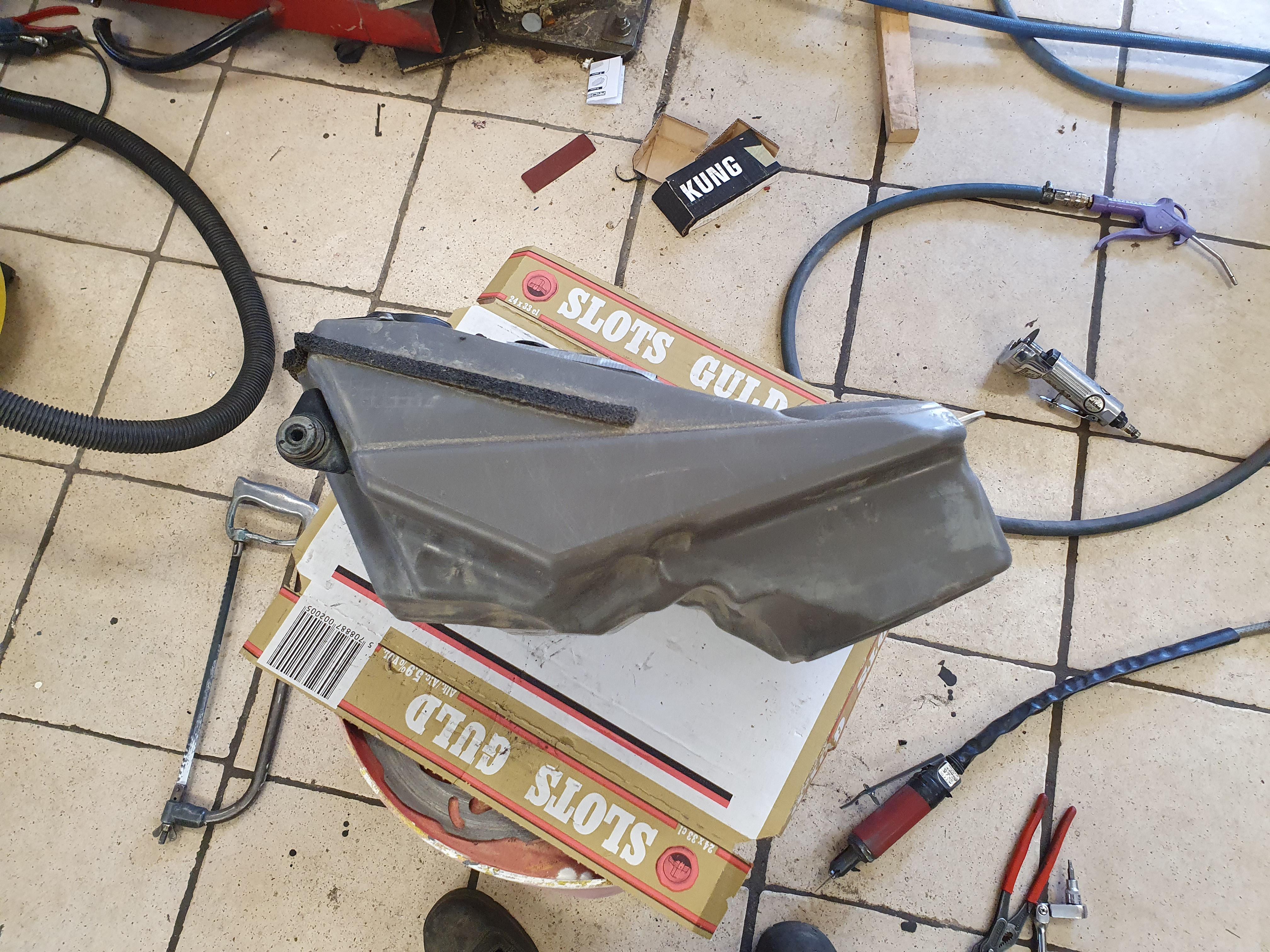

Time to cut up the tank to see where I am with everything:
Cut a little, then a little more.
When the batteries are standing on the motor they are still a little higher than the tank.
The tank should be 5-10mm lower, and that is without any housing over the batteries..
Then there is the 6s module.
There was some extra mm between the rear part of the tank and the seat.
I needed those mm, so the top of the tank had to go.
I couldn't get the cells between the rear chock and the seat, but that space is needed for contactors and fuses anyway.
