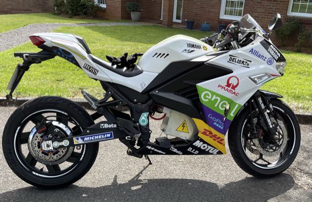

Been a while since I posted an update on the Electric Yamasaki - various lockdowns in the UK have meant time out on the road over the past year has been a bit limited but the miles are starting to build up now.
Only issue has been with the the indicators which was a simple fix and just needed the indicator relay/flasher swapping. Really pleased with how the bike handles and performs and I’m averaging between 40 and 50 miles on a charge which is well within the design spec.
Decided I wasn’t that happy with the overall look and because I did have time on my hands due to the pandemic I decided I would have a go at a bit of a MotoE theme!
Well.....kept me busy with the vinyl and decals :)
