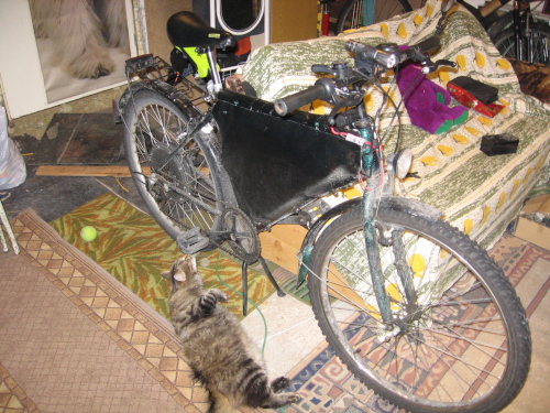

Here's mine, before and after.
Contains: Ping custom-size battery 48v10ah, e-bikekit.com rear dd hubmotor, turnigy wattmeter.
before:
after:
( it is winter to spring atm here, so it is liek very shty everywhere and it really likes to hop on my bike, hard to keep clean atm )
cat smells something funny too.

it doesnt look too pretty i know, my first fiberglass work, will do better next time :)

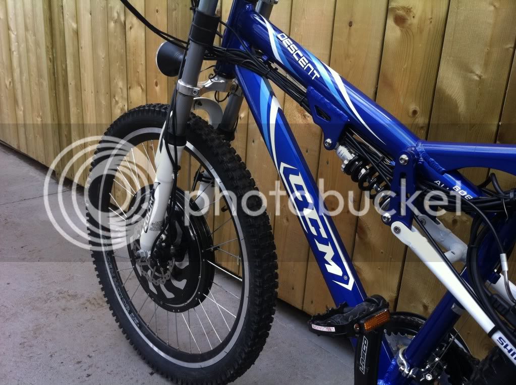

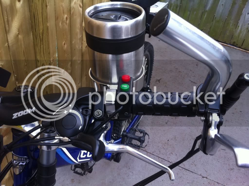

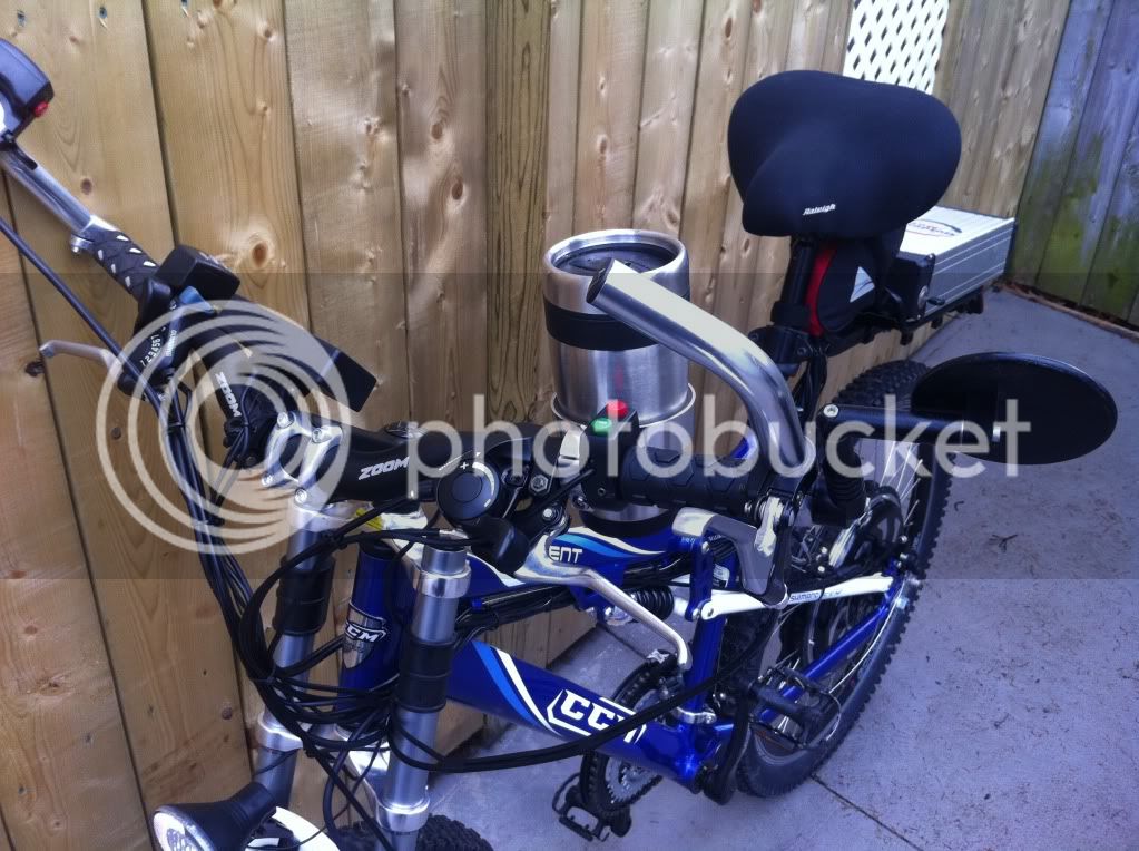

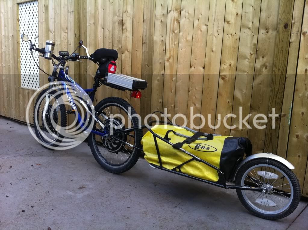

My CCM Build

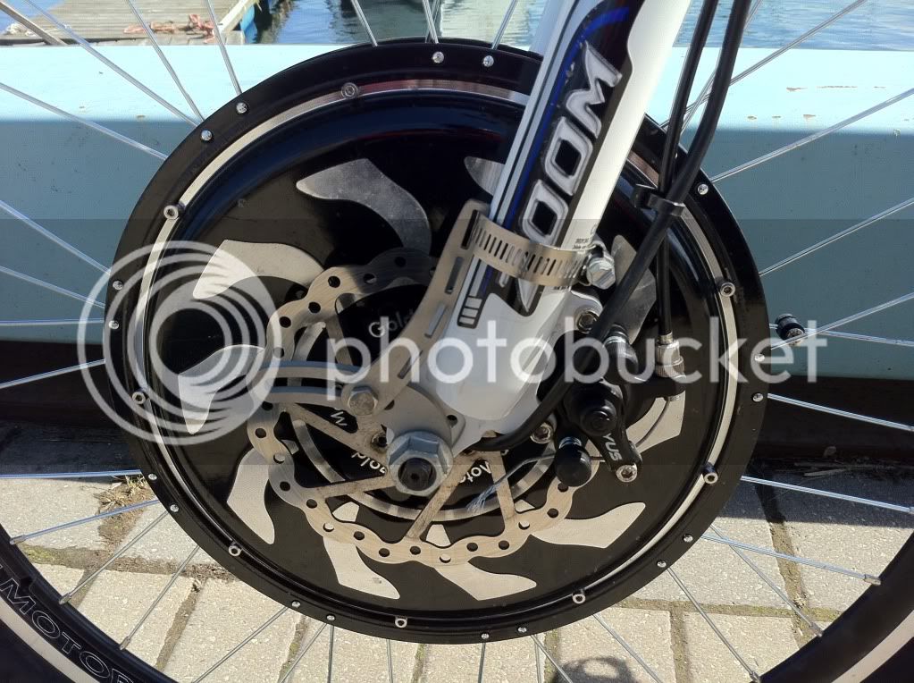

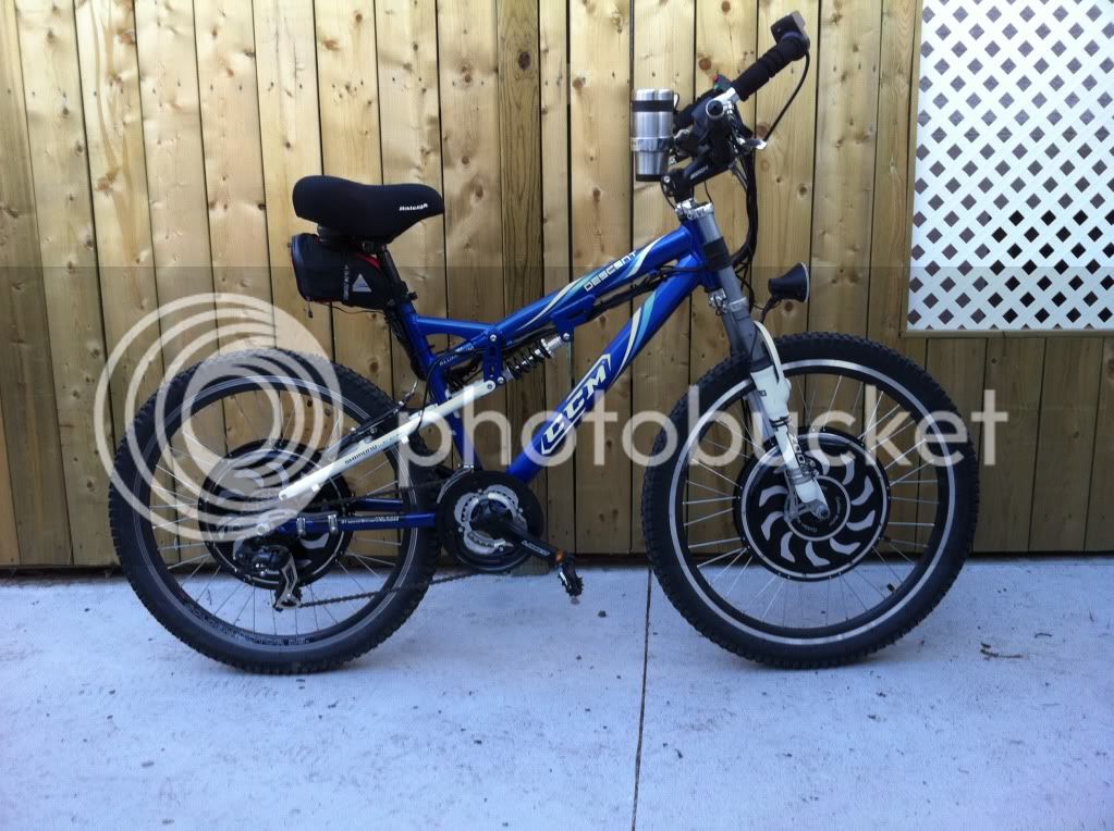

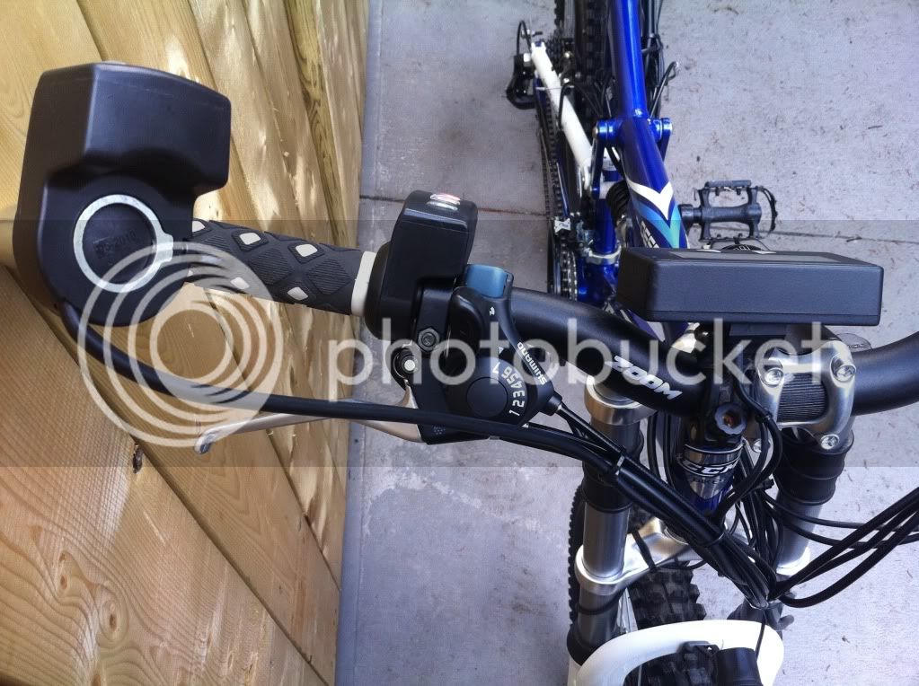

Went to Canadian tire one day for a seat and ended up picking up a new CCM downhill Bike at half price. Added two Magic Pies and the battery is in the trailor. Some of the pictures still show the battery on the back before I moved it to the trailor. I added a second throttle to the right upright bar so I can operate it from either position. I also added a third brake lever to the left upright that operates regen plus the the rear disk brake. The two regular brake levers operate the front disk and the rear center pull brake. So yes, I have 3 brake levers and two throttles. :D
Gary
Sorry no before pictures but here is a link to the bike on the Canadian tire website so you can see what I started with
http://www.canadiantire.ca/browse/product_detail.jsp?PRODUCT%3C%3Eprd_id=845524443324981&FOLDER%3C%3Efolder_id=1408474396672192&bmUID=1301967914931

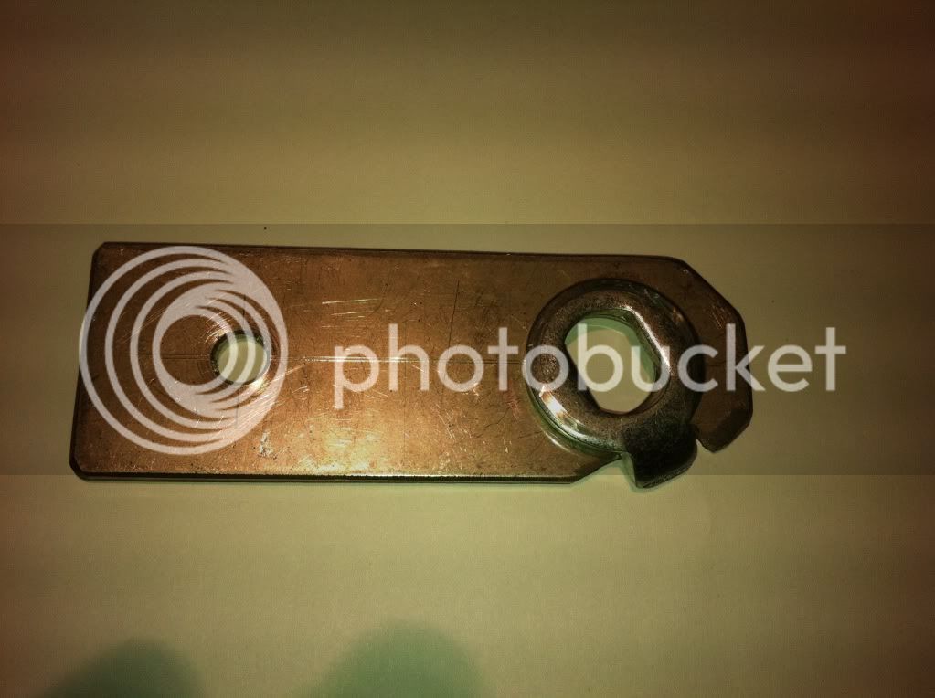

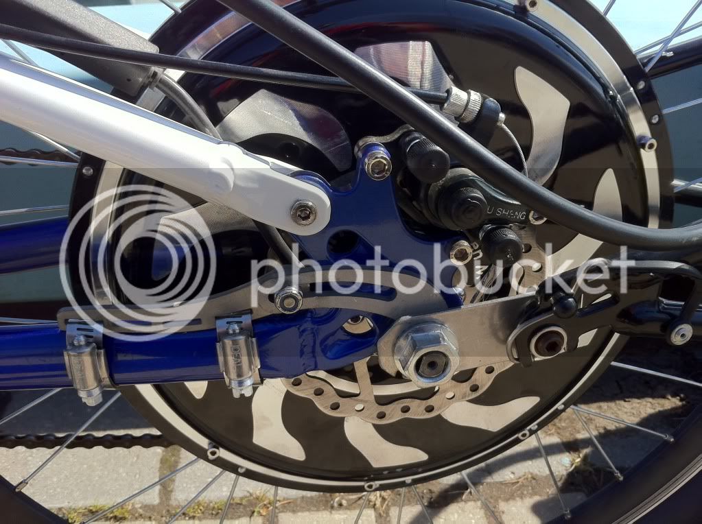

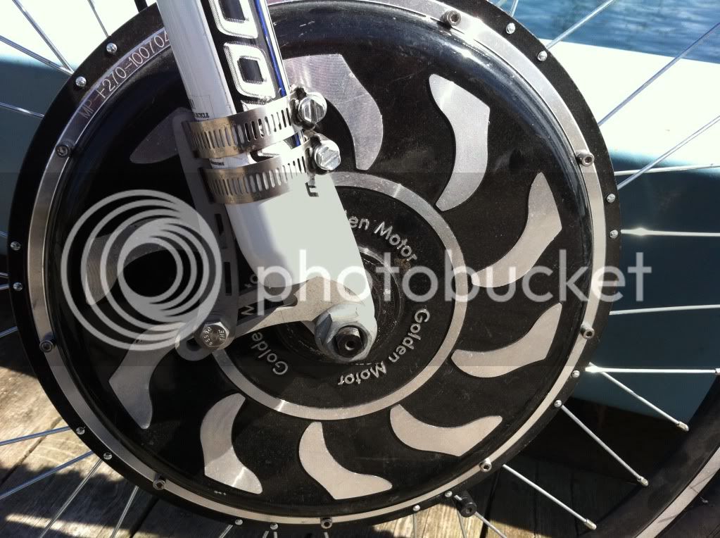

Hi, GMC
Thanks for displaying your intriguing 2-piece torque arms with your pics.
I can find the torque arm sets on your site, but I can't find the adapter piece that mounts the BOB NUTX about 2" aft of the axle out of the way. Do you sell pairs of these adapters also or are they custom? These adapters would allow a standard BOB bike connector fork to work with a 29er. They would also allow for a further aft pivot point which, I understand would make for a less squirrelly pusher trailer setup.
Hello Lemlux,
Sorry for the delay getting back to you. I wanted to wait until i had the time to take off one of my arms to show you what it looks like under the nut :)
Anyway, they are custom made. I made them from stainless steel. Originally I was going to make an oval hole that fit perfectly over the oval shapped GM axle. But this was to difficult so I just made a round axle hole. At first they used to slide down with the weight of the trailor. Then I the cut an angled notch in the bottom and the the GM lock nut fits in to hold it in place. Nothing moves now and they are strong and secure.
Gary
