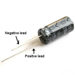

As soon as I powered on, one of the two rods of the second capacitor started to burn (no smoke), same sound that when you light a match. I stopped immediately and removed the battery. This capacitor was really hot. Everything was fine with the first capacitor.
I am officially stuck :) Do you have any ideas of what could be wrong?

measure the resistance of the capacitor (from positiv pin to neg. pin) - is it a shortcut?
The photos suggests that you have connected the negative side of the capacitor to plus (red).
Also, try to keep the leads as short as possible. I.e. Try to mount the capacitor closer to the cables.
Yeah.
It is quite certain that the cap is in bad shape.
better get a new one (selectronic shop at nation).
Ask for the same capacitance AND voltage.
If both caps were wired the wrong way, I would replace both.
I think you also need Low-ESR type capacitors. And be careful with the two ESCs so near together, if I remember correctly, there was somebody here who killed them by letting them touch each other accidently and shorting something out.

Okp, first of all I'd like to apologize for not informing you how to solder the capacitor correctly, it appears to be soldered backwards.
Here is a link to the capacitor that is included with every VESC: http://uk.mouser.com/Search/ProductDetail.aspx?R=UVR1J222MHDvirtualkey64700000virtualkey647-UVR1J222MHD
I'm afraid that the capacitor is indeed damaged and needs to be replaced.

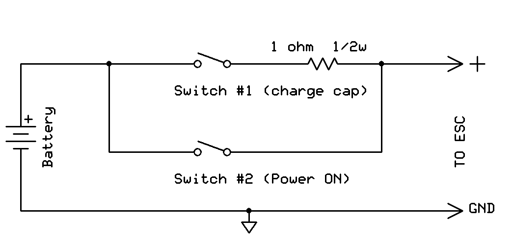

Still waiting for my VESC, but because I build on the battery box I' think about a powerswitch.
I wanted to do something like that:
Then I have read a bit about anti-spark circuits and found that:
Code:
The spark is your friend. If ever you plug your pack into your controller and you don’t see the spark, contact tech support at support@castlecreations.com or (913) 390-6939 and send the controller in for repair. Your capacitors will need to be changed. NEVER fly if you do not see the spark, especially with high voltage applications! The higher the voltage, the bigger the spark should be. Remember, the spark is your friend!!!
http://www.castlecreations.com/support/faq/faq-phoenix_hv.html
What do you guys think? Should I use a anti-spark or better enjoy the sparks and let them eat away my switches?

On 12s and 4400uF, the spark is getting closer to being a small explosion that will make the connector difficult plug in the next time already. On 8s or less, you can deal with the spark. My xt60 connectors have survived on 8s for a year now before I built an anti spark switch. Your circuit would work. You can also use my anti spark switch that I uploaded yesterday:
https://github.com/vedderb/SparkSwitch
Your anti-spark exceeds my abilities :?:
I will run mine on 6s, the Spark definitely shouldn't damage the VESC then? I don't care about switches or plugs they are cheap;)
Just want to know what's the best for my controler, that's the part I want to protect. Preferably simple and cheap methods :wink:

Guys, please have a look at how I mounted the cap on my VESC, just to double check I did not make some dumb mistake, thanks! Soldered according to the picture above (long leg=positive) and put a bit of hot glue on it to prevent sharp edged and give stability.
uc
uc
Nice way to mount it and looks correct to me. As long as the white/grey "stripe" is to your negative you should be fine. I don't recall mine having a long leg, but likely wasn't paying that close of attention. I just made sure the white stripe leg was to the negative wire.
