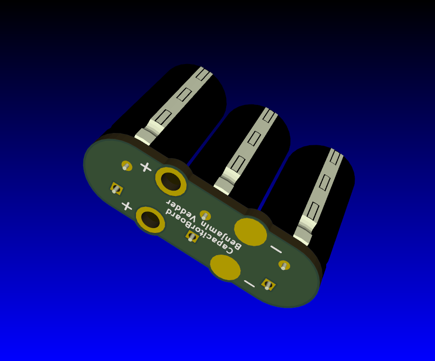

Another thing: I got the capacitor PCBs:
The capacitor PCB can also be placed under the VESC it it fits better that way (this will also put the caps closer, which is good)
SWEET VEDDER.... three caps in parallel is much better. but now only 1680 total. I suppose this is the biggest three caps that can fit side-by-side whilst not increasing the total width of the assembly.

What is the advantage of 3 smaller caps vs one larger cap? Total capacity is less as onloop noted, is that a concern?
I believe This is done purely as a method to make the vesc more compact.. the 2200uf cap was ridiculous.
With the three caps grouped together it shortens the total length required to house the vesc. It's also thinner.

While total microfarad is much less than a single 2000uf cap being used. One benefit for Vedder to do this is probably the amount of ripple current three caps in parallel can handle versus a single capacitor. There's information about this already.
I just checked the specs of the capacitor Vedder has on pic from Nichicon, the HE(M) series are low impedance rated between 4000 hours and 10000.
http://www.nichicon.co.jp/english/products/pdfs/e-he.pdf

This was mostly to make it more compact, but as you correctly point out these caps will have lower total ESR and can handle more ripple current. Here is the PCB on github:
https://github.com/vedderb/CapPCB
Soldering it is easy and there are some capacitor mouser numbers that should work in the README.md.
Cool Benjamin! So seems like that could be the explanation for the power throughput being slightly lower than what should have been expected based on the Current limits alone. Looking forward to testing the new Current back-off settings. I'll see what I can do, I did make a bootable thumbdrive with Linux once but was struggling a bit to get the BLDC installed, and then got saved by Jacob's Win version (hint, hint, :D) so didn't put more effort in getting the linux working. I am going on vacation tomorrow, but with a bit of luck there will be enough space left to take the Kyosho. Got some cool new sandpaddle tires for use on beach, that should be able to generate some nice big loads :).

Regarding the caps discussion, below's a quick little overview of the total Capacitance of the stock anti-ripple caps of some hobby ESCs I know of, as reference, and the amount I have added to the ones I own. Here's Castle Creations' boss talking about ripple Voltage and adding Capacitance to hobby ESCs: https://www.rc-monster.com/forum/showpost.php?p=429895&postcount=4, he basically says you can't add to much Capacitance, but there's diminishing returns above about 1.2mf, which correlates with what is found in the typical 1/8 ESCs. In the end it seems the power demands of the motor/load and the ability of the battery to fulfill that, is what determines the ripple Voltage and as a result, how much (extra) Capacitance is needed to increase ESC robustness/survivability.
