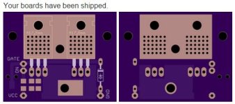

what do you think about that design? it's a fechter 3a version. as i now found an on/on switch i can now switch GATE to GND when off.
let me know if i've done something wrong.
my idea was to make it as compact as possible, while being able to solder DRAIN and SOURCE directly to large copper traces. the whole design is single sided as there was no pros for making it double sided.
the only issue i see is cooling, as the fets don't have direct contact to the heat sink on the back side.
That looks good.
If you want more heat transfer to the back, use a bunch of little through holes (vias) and fill them with solder.
You could also add a piece of aluminum across the tabs on the top side to add surface area.

do you have an on/on switch or an on/off? you need the first one for this circuit to work well. otherwise voltage decline will be very long.
I was thinking you might jiggle things a bit to pick up a little extra heatsink area at the cost of moving the switch Gnd pad away from the board edge...
Not a big deal, but with only two FETs a little extra heatsink won't hurt...

sorry teklektik and fechter. i saw your posts after i posted my new one. i will consider your thoughts and update my design. will got to bed now.
btw: the whole pcb will be bolted to the massive alloy frame box (with a little spacer. so there will be more than enough mass to spread the heat - if there is any. i don't think that it will get hot at all @50a peak.
No problem at all - looks like you already freed the heatsink space I was looking for. Cool.
(I wasn't enamoured with my parts layout - just focused on clearing the space)
Ya - extra FET real estate for 3 or 4 would certainly enhance the desirability.

i changed some things in the design but sticked to two FETs. they are very well cooled, and i don't think i will need more.
i hope the 0.35u thick copper will be able to handle the current. so i added copper to the top and bottom layer, and both are connected a) with thru holes and with the components. i may add some thick copper wires as well?!
i ordered three of them for $12 at oshpark.com. and some SMD parts at the local electronics supplier.
i will post some pictures once i have the boards.
