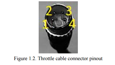

does anyone know the pin assignment of the display connector.
can anyone label which cable goes to 1-4 pin?

The display connector has four wires..
Brown
Blue
White
Black
If you look on the pin side of the connector each pin is numbered 1,2,3,4
Brown to 1
Blue to 2
White to 4
Black to 3
I am not sure why you have shown a cable with 5 wires and those colours, but the above combinations are what mine are. I know as i just resoldered them.
I hope that helps

thanks
that;s the cable from the display side, I have 6 wires and don't know y
as you can see i have no black
I can not find any information on manual or online
is there any way to measure and find out ?
Arh, ok, i have no idea of the controller side colours.

the display side is what I need, because the wires broke inside the connector and I have to re join them.
the controller side is totally fine
The display side of mine has the four wires as stated above. That is weird that you have more than four wires. :?

The Adaptto kit comes with both sides of the connector, are you sure you checked all the items in the box?
Sorry I cannot identify this connector, but you could easily substitute it with any 4-pin connector you have, or that you can get at an electronics store.
Just cut the wire.
Alternatively, you can just solder the wires together without a connector.
