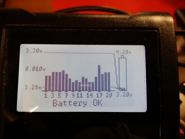

I didn't balance my pack for almost 3 years, it was never balanced. Here is what the max-e reads.
I do know that 17th cell read a bit higher than all the others when I tested with my fluke.

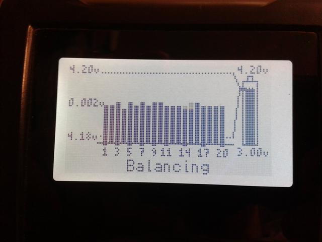

Can someone explain how the BMS balances the cells? I didn't see any thing mentioned in the manual or any options on the display to balance the cells.
I'm not sure if its always balancing or if it only does it at certain times?
Pretty sure it balances when turned on, and, over the balance threshold voltage as set in BMS settings (adjustable ). 'Balancing'shows up on the display when you check the battery screen during this time.
