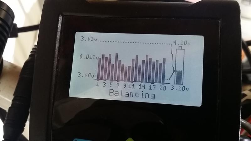

I am leaving my bike on to balance. The balancing actually got worse.

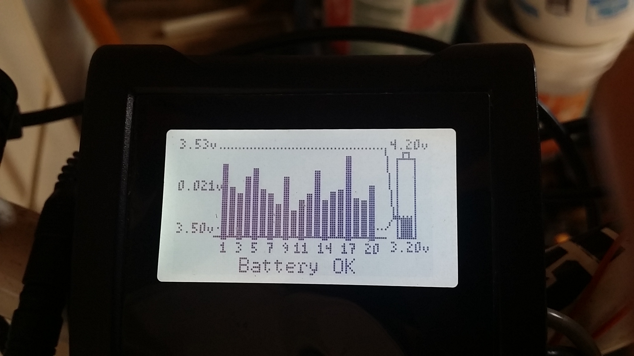

The top picture is the current balance at .012 volts.
The bottom was .010, even .009 volts before I started. Why is my balancing not getting better but worse?
I know its balancing because I can feel the heat through the frame where I put my BMS.
After balancing:
Before Balancing:
Most BMS and the one from Adaptto too has an accuracy of around +-10mV so you cannot expect more.
If you do a voltage calibration with a good DMM you will see what i mean.
The other thing is that during balance the themperature varies which usually makes accuracy worse (temperature drift).
If you wanna do your perfectly balanced battery a favour, don't let the BMS touch it until the voltage exceeds a given value (optimal would be a tad bit higher as the max charge voltage).
I do remember Allex once saying that the adaptto bms had an accuracy of plus/minus 20mv. When i built my battery pack i measured each individual cell before assembly and they were all within a few mv of each other. Once the pack was built and connected to the adaptto bms it read there was a 20mv difference between the parallel groups.
Look at this, left it on for 2 days and it went to .020 balancing.
Notice how every 5 cells started to get really out of balance, exactly like in that other post. If I didn't turn this thing off it would have sent my whole pack out of whack. I may have to even pull this damn pack which is a pain, just to balance it out manually and just use the BMS as a monitoring tool.
its not worth using to balance the pack at all, just to monitor it. Wish I never turned it on to balance. I figured it would even out all the bars at least. I know it may not be perfectly accurate but it was reasonably accurate when I compared it with my fluke volt meter.
Its one thing if the voltage sensors are not perfectly accurate as my fluke meter, but another thing if it can't even out all the bars and have the software level everything out to .002 volts.
If I left this crap run it would keep going from .020 to .030 to .040, keep increasing. total junk.

Spoke with Ziltoid who had the same balancing issue, it could be that I"m balancing at too low a voltage as he think that may have fixed his issue. I set my balancing to be done at 3.5 volts, which may be far too low for this controller.
I'm going to try balancing closer to 4.2 volts.
In bigbore post you can see his balanced to .002 and his pack voltage was 4.18 to 4.2 volts. I'll give balancing at a higher battery voltage a try and see if it does anything.

In most cases, If you balance out the cells at 3.5 and then charge them to 4.2, all of them will not be equal at the top. Same goes if you equalise them at 4.2. Later when you drain the cells to 3.5 all of them will not be even.
So find your favourite spot where you check the cell balance - be it at the end of the ride at 3.5 or in the beginning at 4.2
Here is a new pack, never been charged and the diff is 0.004V. When this pack is charged to 4.2 the diff is is around 0.020
When I then drain this pack back to 3.65 it is back at 0.004V
It is also very hard to balance out the cell on huge packs. Current is so low that the cells self discharge faster because the controller is on In this case you have to top it up with charge a bit and in most cases lower(change them) the balance treshold several times during the balancing. Much easier to balance at the top in this case because you have less energy up there. It goes much faster to drain a cell from 4.2 to 4.1 rather then from 3.6 to 3.5

Allex, you can see in the pictures there is probably an issue with the adappto BMS being that the 5th cells seem to be much higher than the rest.
The longer you leave it the worse this gets, just like in the picture I posted showing the cells going out by .070 volts.
I believe if I balance at 4.2 volts it may balance everything to .002 volts. Then even if I do fall back down to 3.5 volts, the cells will still be under .010 volts. At least I hope this is the case.
I really think this is an issue with the BMS and balancing at lower pack voltages. Going to do some experimentation.
