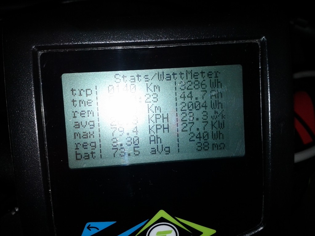

new kW record :twisted:
but unfortunately the 27kw did not flow into the motor but into my small EMC-400 travel charger.
There was a big spark when i closed the connection between charger and battery. The spark turned the entire chinch connector into plasma, burned my thumb, messes the electronic box and all other things near it.. I was charging through the controller to have accurate soc values. After the sparking the controller went into protect.
The charger was not switched on (i forgot) so there was inrush current to the cap. Definitely no short circuit anywhere else.
There is a 5A fuse in the chargers output wire that did not blow :shock:
now the question: is the Adaptto current sensing so extremely fast that it can detect 27kw peak (over 370A at 72V) while a little 5A glass-fuse survives?
if we assume the output capacitor in the charger has 50mOhm esr, than such high peak inrush current could be possible.
more here: http://endless-sphere.com/forums/viewtopic.php?f=14&t=38284&start=550#p1068624
wholy smoked! :lol:
