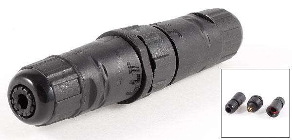

I see that you managed to unscrew the halls connector. For those who are wondreing how:
First you need to leave the halls connector that is on the motor side attached to the halls conenctor on the controller.
Second, release the small cap that holds the cable
Third, unscrew the middle body while holding the motor connector(see 1), you may apply a bit of force there as most of them are secured with some varnish.
