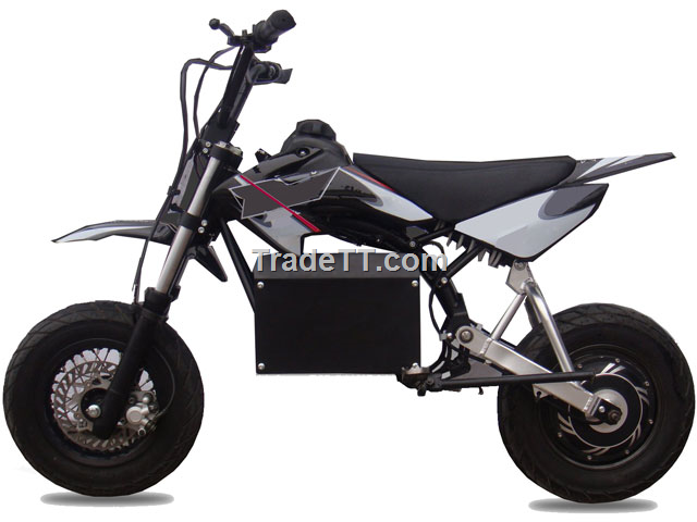

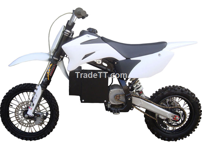

Yeah seen those a while back and studied up on pit bikes. its gona be a heavy bike unless you drill holes through it. might as well start off with the warp frame which has concentric swing arm.
second hand pit bikes are so dam cheap it makes me sick when comparing mtb bikes to them for moving complexity.
try this on google:
type electric pit bike under the images option
theres so many fucken cheap bikes there to mod to more powerful and make lighter and try to make look more like a bicycle.
Yeah. I guess weight isn't as much issue with pit bikes.
Those motoped bikes are 48kg dry weight. I'd be fanging around on that if I could get away with it. With available technology that suits me . Pitty its a noisy gasser and has small power zone compared to electric bldc motor. I guess it would have a power output of 4kw or more. But yeah nice construction of concentric.
Mid drive would be better.
I'd rip all the plastic shit off it and put a fake cranks and pedals and chainline - would be great if they could made to work but kind of pointless.
