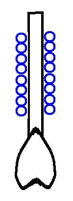

While I'm working on the triangle I'll have two of these batteries
in this case that I already have (hopefully just fit)
(One Side Case): 168*125*50MM
John Bozi said:
Dam, all these ideas were a waste of time. The maximum width that the above idea would be possible is 140mm external of the battery box to fit between the pedals.
Just got this picture and info from Dingo

laying cells down perpendicular to the frame is the hard way to try to fit Headways, because they're so long. In line with the frame will be much easier. Only a handful will fit inside the triangle, but with 1 cell width added to each side of the frame then you pick up a lot of extra space, since the inside of the triangle is no longer your size limitation. The cells can be arranged different ways or even angled, but here's just one idea.
thanks for the idea, have played with this before and went down and reinvestigated it. the bottom tube is about 5cms so it may come to thinner overall and not using the centre would mean I didn't need a new rear shock. The width wouldn't be an issue as there is no pedal to clear up that high, however it would be keeping the weight higher and compromising the handling. The other drawback for me is that I don't have the know how to split a pack.
My plan was to do minimal changes to the pack - hoping balances leads were long enough.
The other thing as in your diagram, the pack will either come above the toptube or below the down tube with a corner sticking out. below would be riskier near the front tyre fully compressed, on top would stick out awkwardly.
The box needed to do them as in the diagram would also be headway specific, so one day when the headways are to be replaced to lipo I will need to build a triangle box again. Building the largest triangle box now will give me lots of choices down the track.
15cm internal width would allow something like 3 lipo bricks side by side - still havent measured this up but it would be perfect if I get 18s3p eventually in the triangle.
