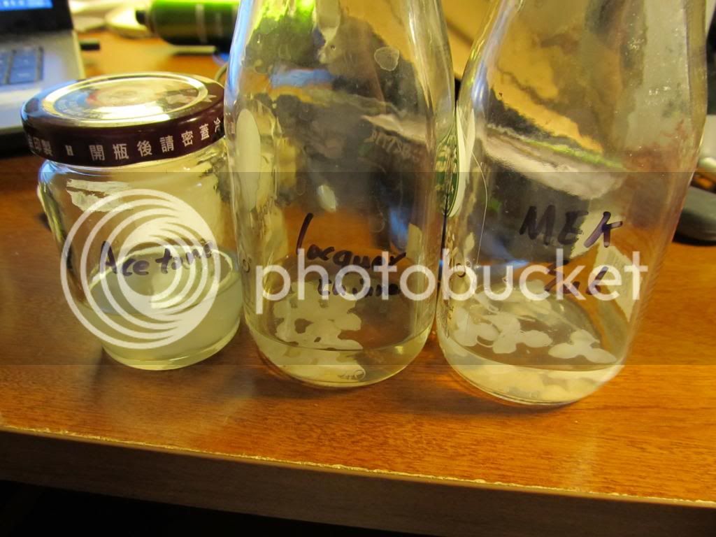

solvents
apart from thermo welding plastics can be dissolved together. seems easier. Just add solvent to both surfaces and the solvent liquefies the plastic together. sure will be stinky stuff.
here's a list I copied from http://nerfhaven.com/forums/index.php?showtopic=18527

I've included acrylic here as I was looking into clear "plexiglass" ideas, could be usefull to have say a box area with clear top to see cell meters or cav3 inside...
Acetone should be easy to get to trial (just look through the mrs's draws) I also have some seriously strong paint strippers to dig up out of the shed to trial.
I will need to have the fan running because all of this stuff is seriously stinking toxic...
testing
I got paint stripper which MEK and toulene (methyl benzene)
and as it says above no for abs, but it also is not doing anything with the pvc. I don't know if there is something else why the pvc is not bonding.
Will try cleaning the pvc first with the stripper and then leaving it to dissolve.

solvent glue welding
Tamiya for abs = It contains both Acetone and Butyl Acetate. Butyl acetate is used in nail polish but don't see a way to get it only without the other additives for nails.
is the only specific I can find cheaply to try. Well if you call $10 for 40mls cheap than yea. http://www.ebay.com.au/itm/TAMIYA-87137-Cement-Glue-40ml-for-ABS-Plastic-Model-Tool-/201190375621?pt=AU_Toys_Hobbies_Model_Kits&hash=item2ed7e180c5
Have been reading interesting stuff on forums for 3d printing usually about various solvents reactions to plastics and making your own glue.
http://www.soliforum.com/topic/2646/test-on-different-type-of-glue-acetonemeksub-lacquer-for-abs/
It would seem the cheapest would be to dissolve some abs into acetone to increase the bond... as I have both acetone and lots of bits of abs rod left laying around now.
