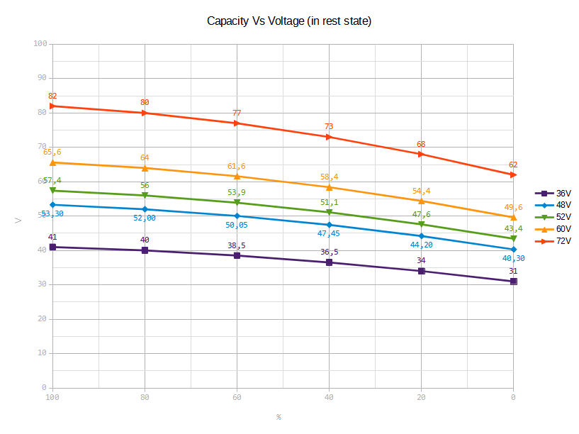

My dm02 experience so far is mixed. Yes there are lots of options to play with in setup and a big plus is you can use a 36 or 48vbattery. Also good clearance between bb and motor housing, better to run cables. Motor is responsive and on par with tsdz02, maybe a bit more power on highest setting.
Two biggest downsides though, it is definitely noisier than my old tsdz02 , almost like internal gears not meshing nicely and also some vibration that can be felt in the pedals when motor is working hard.
Also sometimes a little yellow triangle will flash on the screen amd the motor won't drive for a few seconds
Not sure if I got a bad one, or if this is how it should be for the model
It seems easier to pedal than the tsdz02 when the motor is turned off and build quality seems a lot nicer
However I'm not overly happy with it when compared to the TS , my two biggest issues are the noise and lack of smoothness / vibration from the drive when under load
Also is seems to under read the battery percentage considerably
Anyway hope others who have purchased it are happier with theirs
Did you mean you lose motor assist for a few seconds with the yellow triangle? That's definitely not normal. Did you check the battery and whether it has a solid electrical connection to the motor?
How? All I see is 2 battery voltage options
1) go to battery settings
2) leave cursor/selection at the very top
3) press and hold UP + DOWN on display for few seconds
4) Use these values according to your nominal battery voltage
