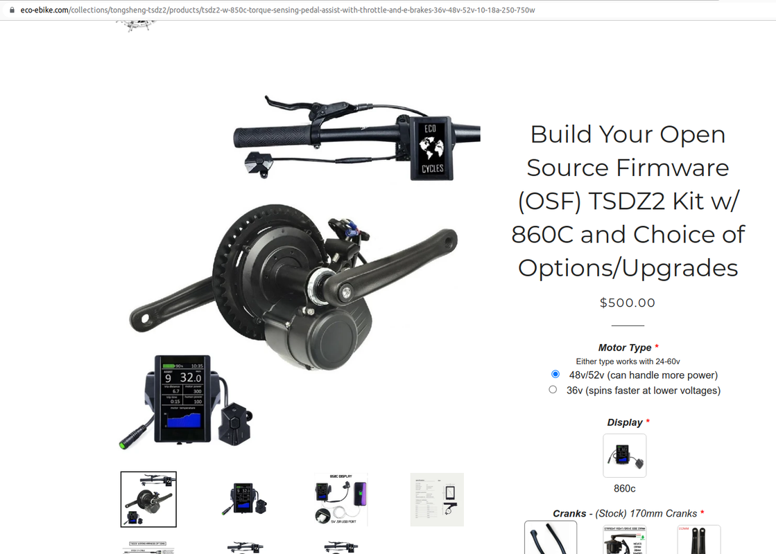

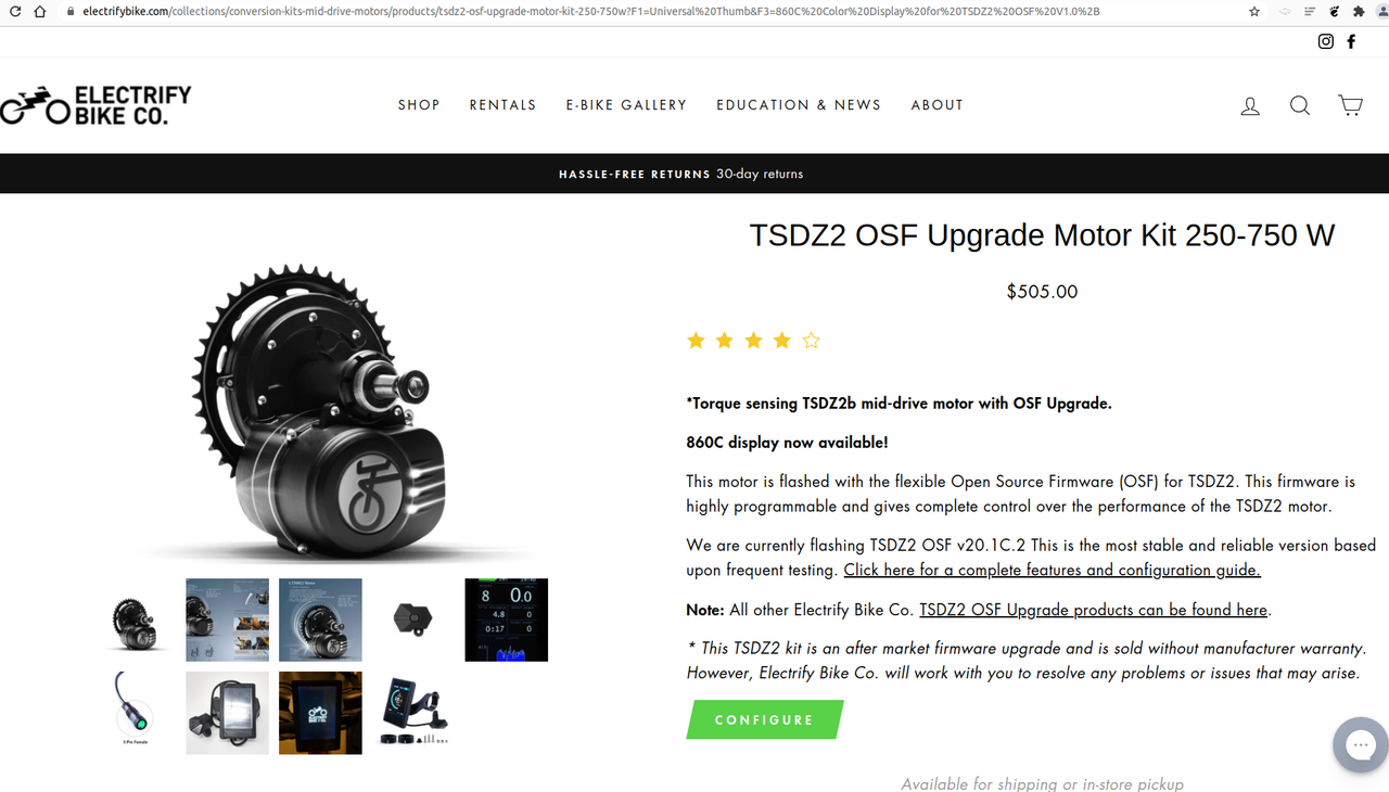

Why reinvent the wheel guys, I know Caisanho loves to reprogram from scratch and probably in the long term creates a better motor. But that development is hugely long winded as in the case of the TSDZ2 which has been developed now for probably 3 years.
Not TSDZ2 only, I started the development of OpenSource firmware for the KT motor controllers as seen on the image bellow. Then Stancecoke did the same for the other popular motor controller that I do not remember the name now.
Even for TSDZ2, we started to do little changes to the original firmware, and looking now some years after, no one is using that firmware but instead our fully developed firmware, because we could add MANY advanced features, things like motor FOC control that uses less battery and makes motor stronger, adding motor temperature sensor, torque sensor calibration, current ramp value, very good battery SOC based on Coulomb counting and recently wireless with integration with EBike wireless standard, making the popular cycling GPS units like Garmin Edge, compatible with TSDZ2. So yes, I agree that is best to have something that bring immediate value to users and then that will help project grow in awareness, attracting more users but mostly important, more developers - and possible more cheap repair parts, which a big part of success of TSDZ2!

And seeing that people are talking about a shop Like Luna Cycles, that seems did some hack to the controller and then marketing like being their super special version, on TSDZ2 with our OpenSource firmware, the story is different.
At begin of the OpenSource project, some shops owners did help the project, providing parts, donating money and help to get access to the 850C and 860C displays bootloader. And this shops decided to sell the motor preinstalled with our OpenSource firmware, including with our own the extra features like the motor temperature sensor - this is very important to some users that lack the time and skills to DIY. Also this shops provides support to build very special ebikes and our firmware have some specific features for it, like Jeff bike:
