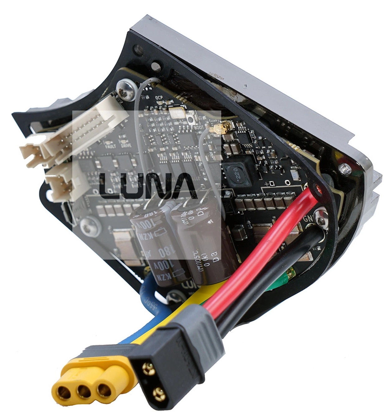

The most challanging part would be if we can make it somewhat cost effective to replace.
To be somewhat reasonable the pricepoint has to be <100EURO.
Can someone please upload the new CRX10NC4818i132046.8 firmware for testing please?
If I recall from my micro Lebowski build I can't even buy the parts for $100Euro let alone the PCBs plus assembly. You'd need to make thousands of them to be cost effective. Isn't luna charging like $500 or something as an upgrade?.
I think they have the V2 as a $400 upgrade right now. Though the previous 'ludicrous' upgrade was $300 and consisted of about 20 cents worth of shunt resistors so who knows what the actual controller costs. Plus, Luna is obviously a business so have to have mark-up on products. I wouldn't be surprised if 50%+.
100 EUR price point might be pretty tough, though. Especially in small quantities. You might be able to build a basic ~500W replacement for that, but if you want to duplicate the "2500W+" V2 controller with all the bluetooth bells/whistles, it would likely run more. Quality mosfets and the big smoothing capacitors can easily run 2-3 bucks a piece and it runs 12 mosfets and likely 4 capacitors. Plus I think the MCU is going to run $15+, so pretty easy to blow a big chunk of that budget in components. Though conversely if the choices are between a $200 open source board, 'nothing', or an 'unobtainable' controller from luna...

Yeah that's why It might even be more interesting to just port VESC to the S32 controller.
The m500/m600 controller board, is actually a super solid board.
The thing holding it back is just the lack of software for the S32 main controller.
