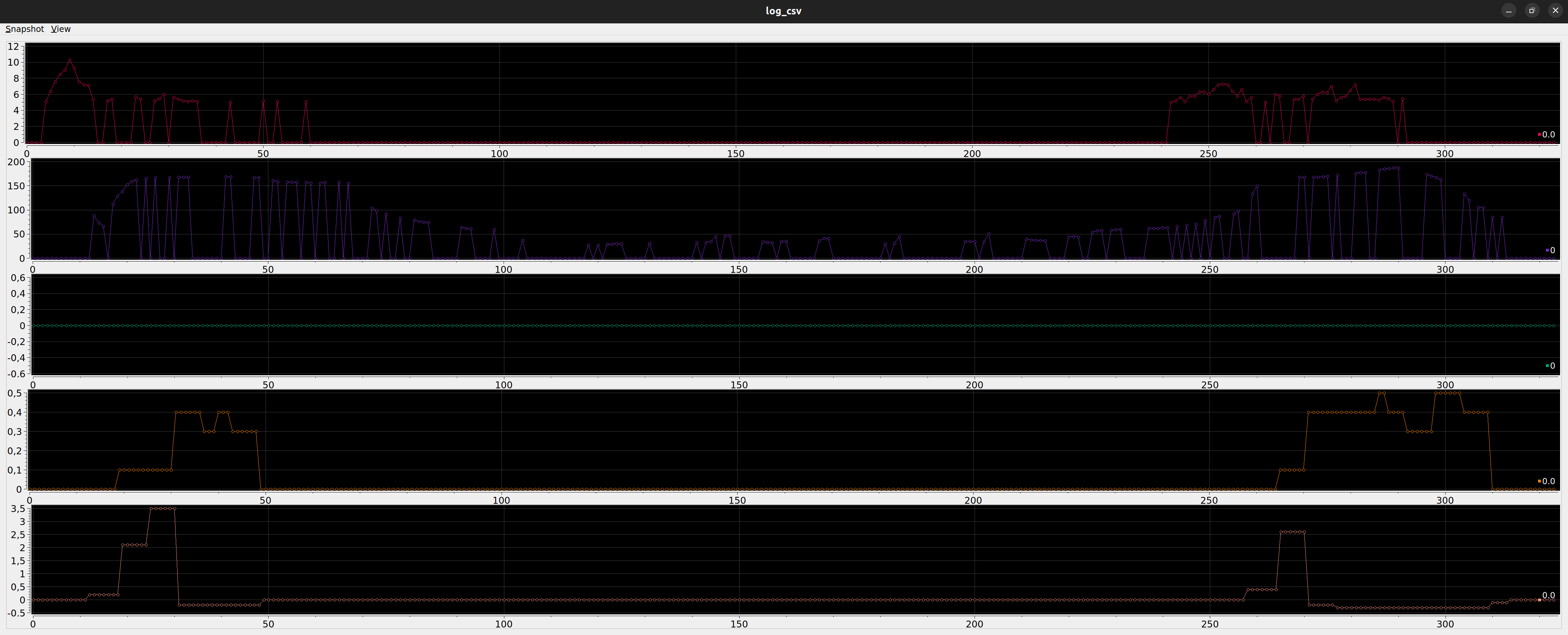

The firmware as also a task code to output some useful data, I get this in real time in my phone:
1. torque weight value in kgs
2. cadence
3. brake state
4. motor current (read from VESC)
My next step is to implement the motor current ramp. Then probably I will connect the display and start riding my EBike while I will be tweaking the firmware to have the motor response I am looking for. In begin of February I will have some MTB events, so by then I hope to have all the system ready, this means also everything water resistant!

On the graphs bellow, this is the data by ascending order:
1. torque sensor weight in kgs (seems to measure very well. That moments that value go to zero is because the motor was rotating fast and is then hard to apply torque on the pedals - hence the very high value of cadence!)
2. torque sensor cadence value (even if I am pedaling, the values are sometimes zero)
3. brake sensor state (never did pressed the brakes)
4. battery current
5. motor current

szkuba said:
2. So to your impression is cadence reading useful or not at all? can we use it for power calculation/low cadence current adjustments?
Nice all this graphs and information.
About the cadence, I don't know yet. For now I only know I see that zeros and that also the VESC code for the Luna controller do not use the cadence, only the torque value. See the code bellow. Also, the way my M500 respond to the pedal, I am pretty sure original firmware do not use the cadence, only the torque to then define the motor current.
The CAN messages have error CRC protection, so I do not think it is an error on transmission. Here is the data package from the torque sensor:
I never looked at the last byte, maybe it can give a clue for when the cadence value is not valid??

casainho said:
For now, motor starts as soon as I press the pedal, but only after a min of 4kgs of weight - that is about the value of my leg when resting on the pedal.
Today I was looking at the values of torque sensor and seems the lowest value of candence is about 15 rpm. Also, seems that at least, one good value is sent every one second.
With this, I think is ok to use candence for pedal human power calculation.
The torque value seems to have good sensitivity and be fast enough to be the only one used to detect the start and stop of pedaling. Like, I can be rotating pedals fast but not doing almost any torque, so on this case the motor simple stops, as my pedal human power is very near 0 value.
I like the boost / peak I get at startup on the original firmware, and I would like to replicate it
So the cadence should not be a big problem starting to read from value 15 but the 1sec reading interval seems to big, those when taken into calculation it can result in jerky operation.
I did not had a chance to ride original Bafang setup hovewer i heard that it is a bit to sharp despite lowest level being to strong. Did you had a chance to ride Shimano EP8 or Yamaha PX-2 or Brose motor on technical uphill trails? Those also have startup assist although defined on different level. For me Yamaha start is strongest (even to strong sometimes) Shimano is in the middle and Brose have the softer start assist. Depending on application this can be either the benefit or a problem. So on flats it is OK but on slippery terrain can be a problem. I was riding Yamaha in the mountain trails and on some technical uphills can be to strong resulting in wheel slip, though Brose have this defined best in my opinion. BTW for the fitness it is better to not have strong start boost , that is my personal view of course ;)
Anyways is your current setup having any overrun? On the video it seems not a big overrun if any, but like to see you opinion from the rides you did, so if it helps to go through pedal dead spot?
I never tested other motors, only TSDZ2 and this Bafang M500.
The overrun / delay to stop motor: the torque sensor seems to be fast to measure, with almost no delay. Then, the only delay can be from the EBike app processing + sending the command to VESC. And the VESC itself is fast to control the motor.
On current EBike firmware, the delay to stop the motor can be lower or faster than with the original firmware - at least I found I could have the delay smaller than the one original firmware has. To configure the delay, we need to configure the current ramp down value - currently I am using 0.05 seconds, which is the time it takes to reduce each 1A, so if actual motor current is 20A (almost the max of M500), it will take 1 second to stop -- here the code:
But anyway, the code is so simple to understand (this can be improved!), anyone should be able to change the simple math equations for what he likes - change them in real time using his phone. So I do not care to much at current project phase. I hope you can build your system and try it by yourself and give your feedback.
Previously I were trying to test ride my EBike but I had the issue that battery power were cutting and I thought it was because some issues with my battery. Turns out the issue were with an incorrect configuration of VESC I did.
Now with the problem solved, the system works perfectly. I think it works at least as well as original motor controller and firmware. The big advantages compared to original motor controller is that I have FULL control of the motor and full control of the firmware!!
On my tests I even found the magnetic encoder sensor is not really needed as VESC sensorless algorithm works very well. But using the magnetic encoder sensor, gives the best startup torque possible.
My EBike is mostly ready to use!! Still is missing the wheel speed sensor, the motor temperature sensor and the display - will be my next steps.
I am also trying to improve the motor cover and hide the best possible all wires, and make everything water prof:
