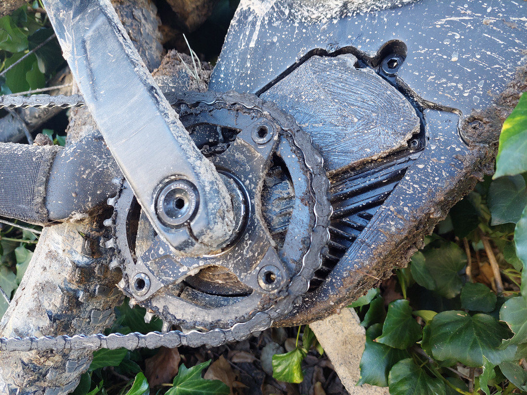

Finally I 3D printed the motor cover in ABS plastic - here it is, and just before I screwed it, I did put a fair amount of silicone to make sure it will keep the water prof:
Then I went to my battery of 14S / 52V and removed a group of 2 21700 cells, to make a 13S / 48V battery because this VESC FLIPSKY Mini FSESC6.7 can only handle up to this voltage battery:
And for the power off all the EBike electronics (VESC, EBike board and display), I am using a button on my EBike frame that is specifically to turn on/off the EBike. Since I am using the JDB Xiaoxiang BMS, I just connected the 2 wires it have specifically for this function - even better, this EBike frame Dengfu E10 + battery case, has 2 specific pins that connect this on/off button to the internal of the battery, that I then connect to this BMS on/off switch pins.
So, this JDB Xiaoxiang BMS is great for power on/off the EBike electronics, but it also can be easily configured for a 13, 14 or 15S battery, so I just did it, configured from a 14S to this "new" 13S battery.
As the electronics are tested and are final, now I do not need to get my hands dirty anymore. Now I am just improving the firmware and as I do it wireless, it is a very clean phase of the project :D
I also started the final documentation but I will take some more days to finalize it.

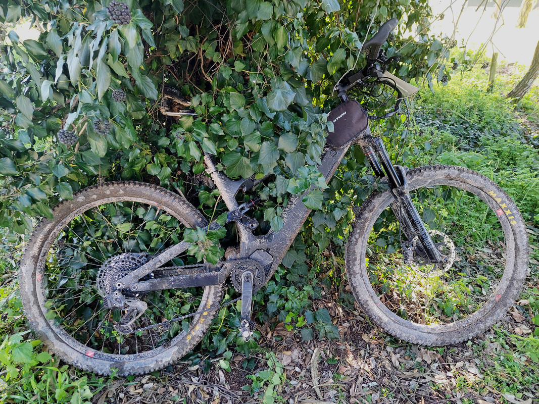

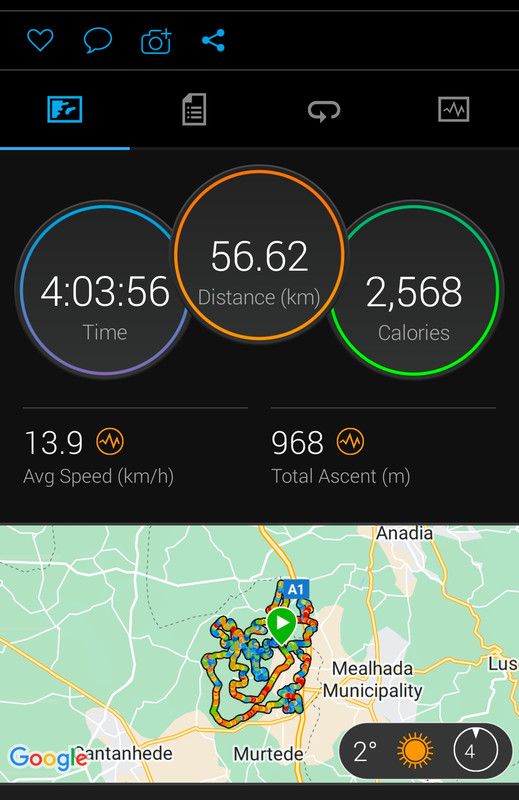

Yesterday I did a ride for 4h and it was a good test. Everything is working as expected.
I was looking at the VESC temperature at it was never over 42º Celsius (but ambient temperature were low at around 10ºC), while I think the max for VESC would be 100ºC. So, this small VESC seems very good for the task!!
Also about the sensorless motor startup instead of magnetic encoder as on original motor controller, I did not notice anything.
There was some mud, but not to much:

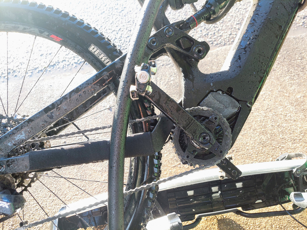

Detail of the motor 3D printed cover in ABS plastic:
In the end, I cleaned the EBike with pressurized water, as I am confident that 3D printed motor cover, with the silicone I used on it, is water prof enough to handle all this water:
So, the hardware is working as expected. Now I will focus on improving the firmware, as currently this is just driving the motor based on the pedal torque value and choosing the assist level on the display. There are missing features on the firmware, as measuring the wheel speed to show on the display as also the important walk assist. I will also focus on the final documentation for How to Build.
