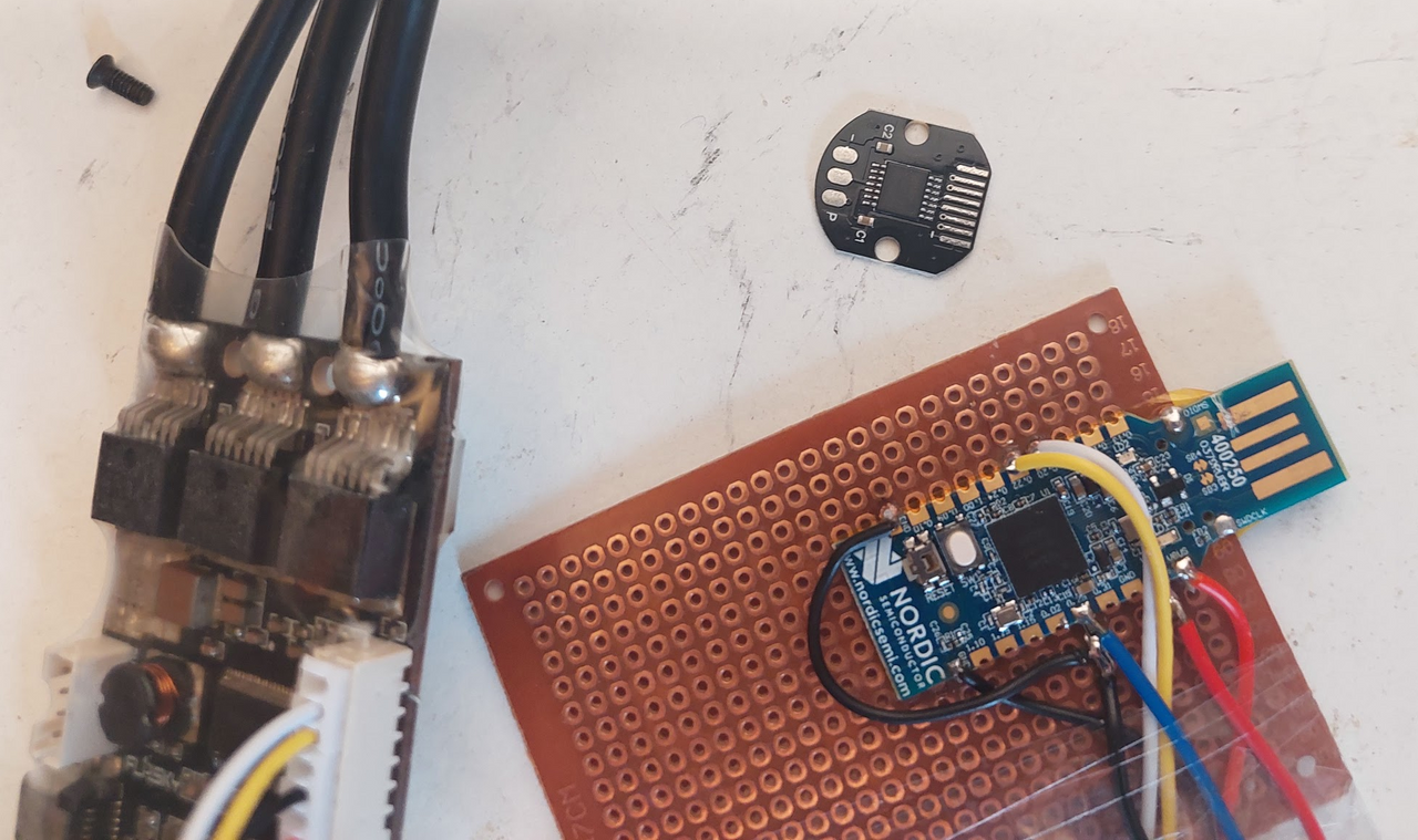

Meanwhile, I just found in stock an encoder board (that round small, black board), from other project I never finished. This means I can test the motor with this encoder, and this cheap VESC controller I have. The only think I miss is that VESC controller that is small. And this assuming I will not burn one of this pieces during the development :wink:
There is a lot of work on the table, if I will be doing it alone, It will be slow. Is there anyone available to help in like testing the encoder board? would need to design and 3D print a cover to keep the board in place - similar idea as done here:

Today I tried to read the torque sensor, but seems the issue I am having is because the Python drivers for MCP2515 are for Adafruit boards that uses a 16MHz xtal on MCP2515, while the cheap chinese module I am using uses a 8MHz xtal. I am now trying to change the drivers is a way to accept both 16 or 8MHz, and then submit a pull request to this drivers, in the hope Adafuit will accept this contribution and also make life easier for future users of this cheap modules (that includes the users of this project).

On the development, I am currently blocked because the Adafruit CircuitPython drivers for the MCP2515 do not work for this board, I am still trying to make it working.
