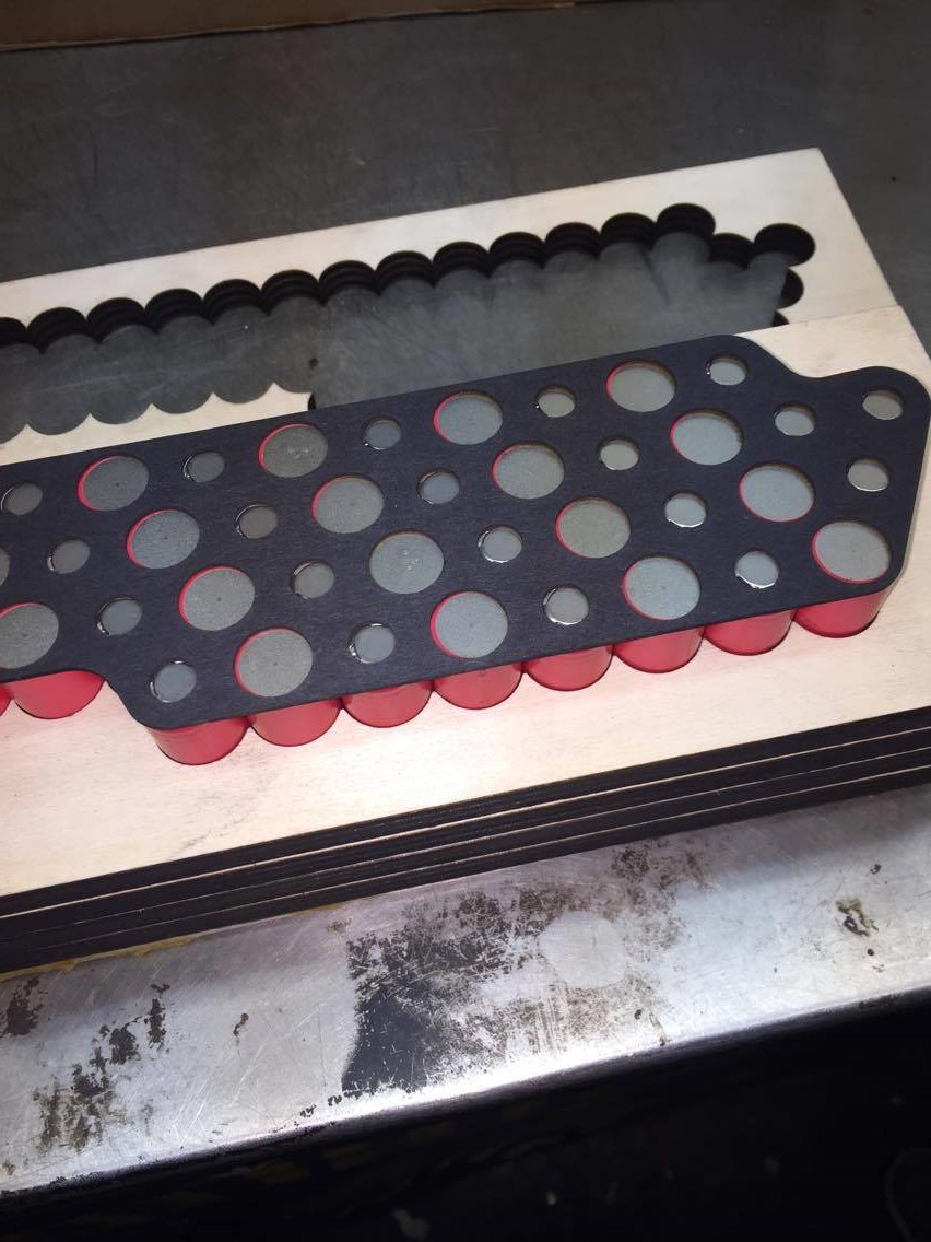

And some pictures, how that you squeeze 70 18650 battery's in the case.

Cell layout:
You can find these pics online:
But this layout will NOT fit a Jumbo shark case (Hailong 2)
The top row of 6 cells has to move 1 cell to the right.
And you can not use the switch and the USB plug that come with the case.
Layout should be like this.
But the spacing between cells has to be very accurate.
I always make a mold first with my CNC router to make sure the cells are correctly glued.
Picture of a 14S4P mold.

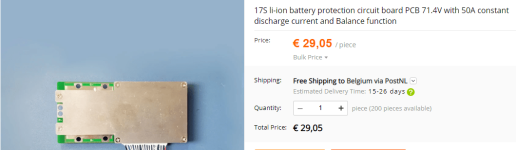

I have found a BMS with good dimensions I think :D
but it's not a smart BMS
https://www.aliexpress.com/item/17S-li-ion-battery-protection-circuit-board-PCB-71-4V-with-40A-constant-discharge-current-and/32813592803.html
What power are you aiming for?
On the previous page you said:
jpc6000 said:
This should be for me better, than I can use 72V ...
the 17S 100A Smart EV li ion battery PCB board Bluetooth Mobile BMS for 71.4V Li-Ion 18650
And the battery SAMSUNG INR18650-35E UNPROTECTED 3500Mah /13A max
17x4=68 battery's
Samsung INR18650-35E only has a continuous discharge of 8A
Nominal voltage is 3.6V so a 17S gives 61.2V nominal.
A 17S4P Will give you 61.2V with a continuous discharge of 32A = 61.2x32 = 1.958Watts (827Wh)
You should go for the Samsung 30Q with a continuous discharge of 15A and a 50A BMS 61.2Vx50= 3.060Watts (724Wh)
or if you want a bit more range: 14S5P Sanyo NCR18650GA continuous discharge of 10A 52Vx50= 2600Watts (912Wh)
