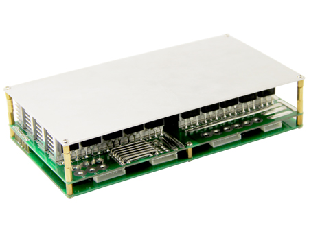

im using the D167.
I assembled the pack with balanced cells. I made this test now to find out if the bms would balance the pack in this situation.
If the BMS cuts out the current from charger to battery if one cell hits HVC, i think something is not working properly. I was expecting the bms would start draining (what it did) and the charger would still send current to battery (what it didn´t). It will start charging again only with a ¨reboot¨.
no, that is the way it works. if you look at your data sheet you will see that it has a reset voltage you have to lower the cell voltages below in order for it to restart the charging cycle.
this is lipo, not lifepo4 so it is made to prevent you from accidentally overcharging the cells. under normal conditions a lipo cell never reaches the HVC.
what voltage did you ask henry to set the LVC and HVC at?
i asked for 4.20V.

not sure if you are asking me for advice. you are trying to see if you can fit some HK lipo into that aluminum box and need a 7S BMS to do it?
24V is absurdly low voltage, could she use a 36V lifepo4 pack? she could buy a 36V10Ah lifepo4 pack from sunthing guy for less than $250 i would expect. that would last longer and be more reliable/less risky imo.

if the controller is limited to 15A then look at the smaller BMSs than the D167. i have used the D126 at 15A continuous but it will burn up in excess of 22A continuous. i just ordered another one for a 13S li ion calibike pack called the D127v2 which has a cover over the circuitry and is 15A. i get good deals since i order a buncha stuff at the same time and he charged me about $20 as i recall.

Over the the last 18 months with these BMS units, how reliable have you found them? Are they really gogin to work as a good plug and play system that I can build a pack for, for some one that wants plug and play, Are they reliable?
Thinking of one of the 80 amp units for the Bomber and the 150 amp unit for myself.
Any recommendations as to which 80 amp unit to go for? or should I go for the 100 amp for the Bomber?
NeilP said:
... Over the the last 18 months with these BMS units, how reliable have you found them? Are they really gogin to work as a good plug and play system that I can build a pack for, for some one that wants plug and play, Are they reliable?
yes they are. it's a plug and play system. very convenient. the only drawback they have is that they don't sense if one of the balance leads falls off or looses contact to the cell. so it could be that one balance lead is broken and this cell group will not be monitored. don't ask me why that can happen, but it can. another question is how likely that is?! every 10 charges i check the cell voltage directly just to be sure - there's never been an issue on both of my bikes. for my 4.2kw klein bike @80v i use the 80a bms and never got nearly warm.
