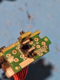

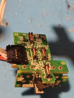

I want to run a Bosch Gen 4 torque sensor on a VESC controller, so I measured its harness. The coil arrangement turns out to be a closed ring of four equal coils, i.e. a bridge. I have not found this documented anywhere, so here are the numbers. What I still need is the excitation the Bosch drive unit applies to it.
The sensor
Measurements (unpowered, disconnected)
Resistance:
Diode mode:
What that says
Wires 1-4 are a closed ring of four equal coils. For a ring of four equal elements R, adjacent nodes must read R||3R = 0.75R and opposite nodes 2R||2R = R. Taking R = 30.1 ohm from the diagonals predicts 22.58 ohm for every adjacent pair, against 22.6 / 22.7 / 22.7 / 22.7 measured - 0.3 % across four independent pairs. That matches the four coil designators on the board.
A four-element ring tapped at all four corners is a bridge: excite one diagonal (1-3), read the imbalance on the other (2-4). Torque unbalances it. Note this also means a single adjacent pair cannot be driven in isolation - current takes the 3R path around the ring as well.
Wires 5-8 are a separate network, coupled to the coils only through megohms. 5-6 reads the same in both directions in ohms mode (the ohmmeter's sub-0.3 V never opens a junction) but shows a clean 0.734 V silicon drop in diode mode - so a resistor in parallel with a junction, i.e. it goes to the IC: probably ESD structures, possibly an NTC for temperature compensation. 7-8 is capacitive, no junction.
The coils themselves come out to the connector directly, with no silicon in the path - a junction in series would have destroyed the 0.3 % symmetry above.
Questions
I will post whatever I measure - inductance, excitation, the front-end schematic - back into this thread, so it ends up documented somewhere public.
@stancecoke - you have done a lot of work on open source ebike firmware and on torque sensors, so if you have ever looked at what a Bosch drive unit puts on this connector, or have a view on driving this bridge, I would be very glad to hear it.

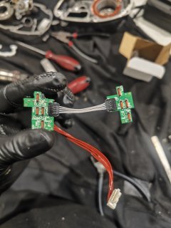

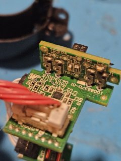

--- UPDATE: after opening the drive unit ---
The sensor has eight coils, four on each of the two boards. So each 30.1 ohm bridge arm is two coils in series, roughly 15 ohm each - electrically a ring of eight coils tapped at every second junction, with the 4-5 way flex between the boards carrying those nodes across. I suspect the windings alternate at plus/minus 45 degrees, since torsion puts the principal strains there and that would make bending and temperature common-mode, but I have not confirmed it yet.

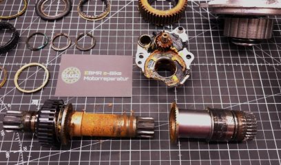

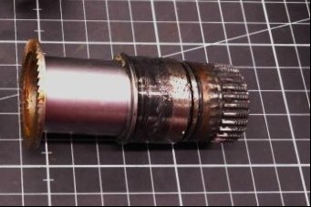

The spindle carries a magnetic band or sleeve, so the sensor is useless without its own bottom bracket. What I still do not know is whether that band is permanently magnetised or only magnetostrictive. That decides the whole front end: a magnetised band emits a torque-proportional static field, which a plain coil cannot see and which needs a fluxgate-style drive, whereas a magnetostrictive band changes permeability, i.e. inductance - which is exactly what a bridge is built to measure. The bridge topology argues for the second.

And question 2 becomes a ten-second test for anyone with a spindle on the bench: hold a small compass against the band on the shaft. If the needle reverses, the band is permanently magnetised. If it only attracts, it is not.

- Two small boards joined by a short 4-5 way flex, test points TP1...TP16, coil designators L1, L3, L4, L7 next to wire-wound coils, one QFN IC (U2) carrying a two-letter marking only.

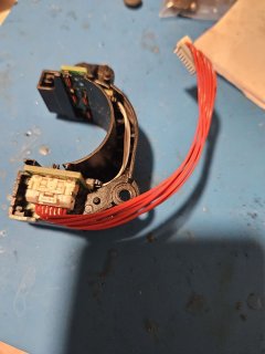

- Assembled it is a horseshoe carrier that encircles the BB spindle without touching it - so contactless inductive coupling.
- Harness: 8 wires, 8-pin fine-pitch JST (~1.0-1.25 mm). All eight wires are the same red colour, so everything below is numbered by connector position, pin 1 taken from the connector key.

Resistance:
Code:
1-2 22.7 ohm 1-3 30.1 ohm
3-4 22.7 ohm 2-4 30.1 ohm
1-4 22.6 ohm 1-7 open
2-3 22.7 ohm 3-7 open
5-6 6.45-6.47 kohm, identical with the probes reversed
7-8 18.2 -> 26.6 -> 27.96 kohm, drifting upward on every reading
1-5 ~5 Mohm, wandering
3-5 ~4 Mohm, wandering
