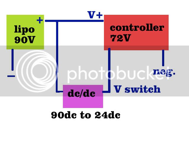

your controller may be shutting down because the voltage to the voltage regulator may be too high. you need to go see what the input and output of the 12V regulator is when it has all the packs in place.
or you could use the converter like richard outlined in his thread. find one that uses 120 V AC, and then open it up and attach the top of your 88V pack to the output of the rectifier bridge on the input of the charging brick (AC adapter). you can then use the output from the charging brick to feed the input to your voltage regulator if it is above 12-13V, up to 18V is ok too. if you can only get 12V out of the AC adapter then just bypass the votage regulator and put your connections right on the 12V rail where the capacitor is and use that for your controller current, and put it on a switch to keep from discharging your pack when it is not in use. you actually could get away with taking a 14-15V output and using it directly, but it is best to go through the regulator.
you will have to deal with the LVC though, if you use a DC converter source for your controller current. but you can make a resistor bridge off the 5V rail to the LVC resistor to keep the LVC signal line high enuff that it doesn't shut down. the setpoint is about 2.58mV on the infineon 846 chip.
also you can modify your current DC converter by finding the Vin to the oscillator pwm IC controller in that 8 pin package. look up the spec sheet and find Vin on the oscillator IC. then follow the trace on that pin back towards the input to the transformer and you will find a resistor in that line which you can change (decrease the resistor to increase the current through it to Vin) and that may allow the oscillator to start up if it sees a higher voltage on the internal voltage divider inside the Vin pin input.
Do you mean something like this ?
and in the 72v controller it will be connected straight to the LM317 which makes a clean 12V and 5V ?

yes, your power lines to the FETs is separate from the controller current line. the controller current normally goes through those big power resistors to drop some voltage before it enters the voltage regulator. if the power resistor is too low in value then the voltage on your voltage regulator could be too high and that pulls the 12V and 5V rails up inside, which might cause the controller to shut down. usually they just blow up and smoke a lot.
if you use the idea from richard of opening up a regular AC adapter for charging a laptop or other mid voltage range device, then you can use the output from your high voltage battery and attach that voltage right inside the AC adapter where the rectifier diodes normally have output. since you don't have AC then you need to get right to the rectified side of the diodes to make your connection from the battery.
that voltage will then drive the oscillator circuit in the switch mode power supply and the AC adapter then will become a DC-DC converter producing DC volts identical to its rating from normal AC operation. usually 19V for a laptop.
then you would use this 19V output and connect that directly to the input side of the LM317T and that would then create the normal 12V and 5V circuit currents.
the problem with using a separate source than the main Vcc for the input is that the LVC resistor divider bridge is also taking it's high lead voltage off of the Vcc and if you have no voltage there, then the microprocessor will shut down because it needs a voltage on that LVC detect pin to operate.
you can defeat this, and use your DC converter, if you can make a new bridge that runs from the 5V rail over to the top of R12. on the infineon this resistor to ground is 1200ohm and the high side of the bridge is 17megohm for a cutoff at 30.5V of about 2.6mV to the pin on the microprocessor. so if you use 5V, use a resistor smaller than (5/30.5)x17Megohm or smaller than 2.78megohm.
your processor may be different and have a different processor and inputs, but the idea would be the same for any processor that needed to have fixed replacement voltage for the LVC.
track it down and we can help, richard knows this stuff better than me though.

The first shutdown was because of the DC/DC convertor !! that one died when it got 87Volts!
Then my 120A/12V circuit breaker went off...i first thought it was my controller...but in fact it was the DC/DC convertor which was blown up.
Now i did a bypass with a seperate lipo of 14.8 to provide the power for my lights etc.
After doing that i had no more problem connecting all lipo's fully charged on the controller! no shutdowns !
The shutdown in my first testrun was because i had installed a lipo pak with only 72 volts ( fully charged!)
so when it gets a load from the hub motor it went down to 64V and that's why the controller shutted off.
