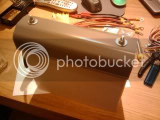

So i was browing this morning for some parts to make the lipo packs ad i found my stuff !
These are the ones for 4 lipo's !
and this one will be the top where all wires come in and are paralleled inside of it. On that i will place the neg. and pos. with 8M bolts and a final balancing wire.
So journey accomplished ! :p

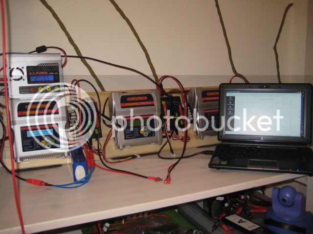

I have organized my Lipo Balancers on my shelf to get some room for putting the lipo packs on it when charging.
Yesterday i received my 200W 6S charger from hobbyking with usb port. I installed the monitor software and hooked it on.
Like the graphs that shows all processes.

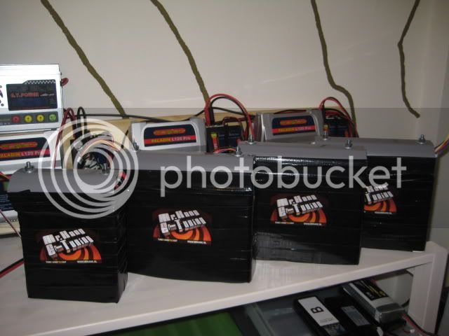

Batch no.3 has arrived !! finally i can do some pre-work this weekend building my lipo packs.
LET THE LIPO'S BE JOINED TOGETHER !! :p
i started making my lipo pack this weekend. All parts were arrived and did some shopping for nuts & bolts.
and then 3 more of these packs.
BATCH FOUR !! and the last one. It's time to build off my 22S4P Lipo pack!

I charge them seperate with my lipo balance chargers. in total i have 4 lipo packs. and i have 4 chargers with balancing. I charge them with 10A and monitor them with my PC.

The Power Source is Ready to Discharge !!
Upcoming days i will exchange the old controller with the modified 100V controller and give it a spin.
I'll keep you updated.

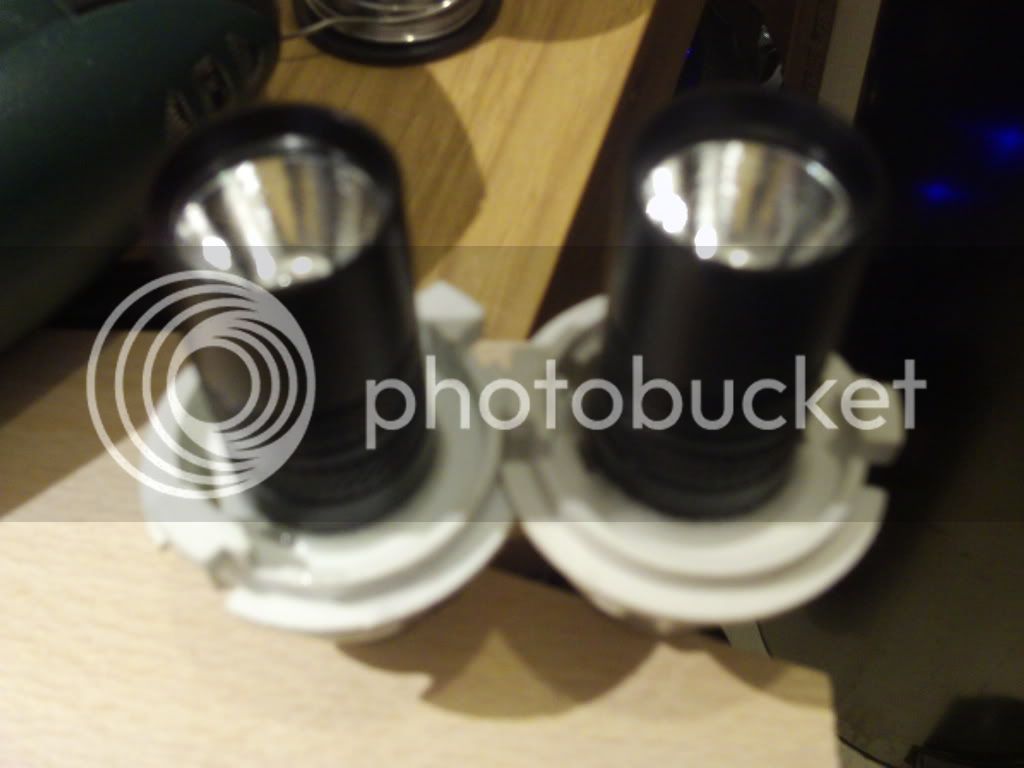

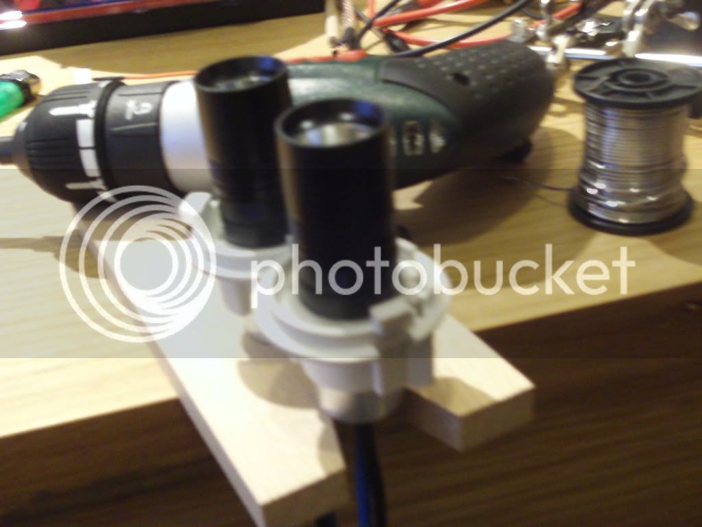

Didn't do much this holiday week. accept for modifying my headlights with some led and cre-x leds

So this one is a different scooter? Audi headlights ftw.
