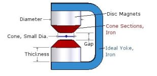

Earlier in the thread Lebowski showed a diagram with an "ideal yoke":
Screenshot-8.jpghttp://endless-sphere.com/forums/download/file.php?id=104807
If I understand correctly the Yoke bridges from one magnet disk to the other -and from one magnet to it's opposing brother (sister?!..).
How would this configuration compare with the ones you are now modeling?
-Structurally an advantage would be that the yoke would be plenty strong to keep opposing magnets from attracting and flexing towards one another (so the structural aluminum plates holding the magnets and iron could be thinned down). Of course this configuration would require the stator to be attached from the axle instead of from outside -making it an outrunner motor.

I wonder, what if we take your proposed situation but get rid of the 'focussing' magnet and just make the main
magnets so big that they practically touch ?
Then you'll get much more flux short-circuiting...
Agreed. The rule of thumb is to use the magnet thickness as the basic guide for magnet spacing.
I think that with the smaller square magnets that your HB effect is too small to be worth the extra cost of material and tooling for assembly; I toyed with that arrangement in my studies, and the very best that you can achieve via that route is a slight reduction in back iron thickness. However to be truly effective, the magnets have to be the same thickness for HB Array, which only increases the gain by √3 to one side, requiring little to no back iron, though 2X the tooling cost for flux in two directions on custom wedge-shaped magnets. Even with all of that - (and let's just say "money was no object" so we're not constrained financially)... the end result is still problematic on two fronts:
  • You cannot go into production using a HB Array because the patent holder would not like it.
  • It is still less efficient than traditional AF layout using a single style wedge magnet with back iron because you have 2X the distance to cover between alternating poles even though they have √3 more flux.
For myself, it was an economic decision as much as it was pure math which direction to follow. :)
From the peanut gallery, KF
