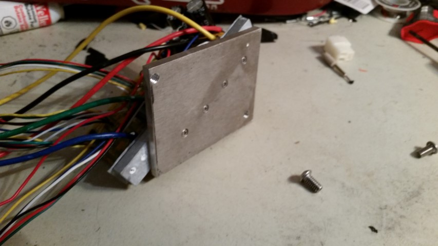

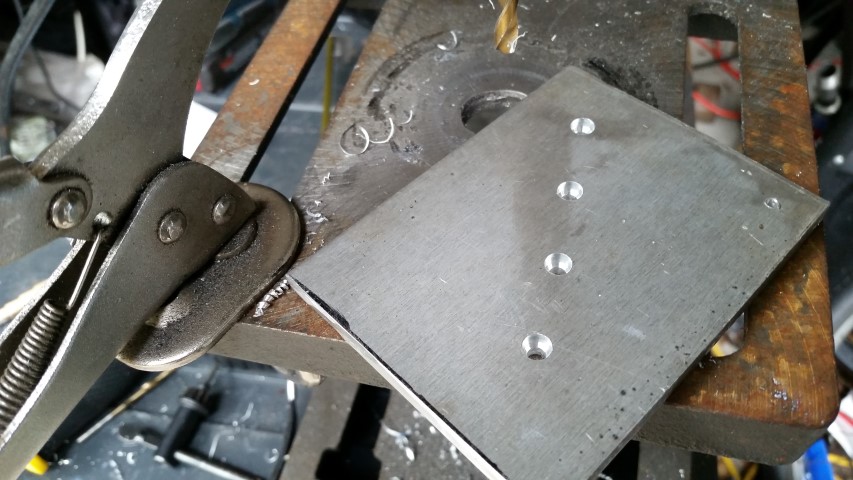

Im pretty confident on everything except mounting it. Unlike most of you, I am not using it on a bicycle, instead I am using it on a scooter.
I have to mount it on an aluminum plate... thing is, the bolt holes go out the side, so I cant just bolt it to the plate. Now I supposed I could drill and tap the base, but I dont think thats best for warranty reasons. lol.
So far the only idea I have is to stick some metal pins through the holes, then use some kind of clamp on them. but I dont like that idea very much. I want to be sure its firmly and solidly on the heatsink, as I plan to use it at 100% capacity all the time. (20ah of 16s lipo and theres no pedal-assisting on a scooter)

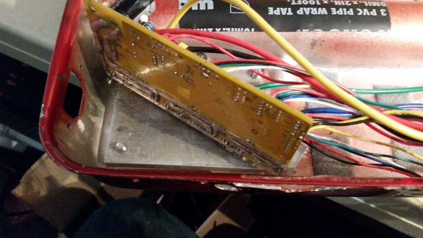

This is how I mounted my previous controller:
(not shown is the plastic spacer that supports the card)
In my setup, the entire scooter pan is aluminum and makes a ok heatsink. The idea is the plate takes the heat from the controller, acts like a decent thermal spreader to the pan, and the pan is in the airflow.
what I would like to do for this controller, is somehow mount it to the plate (with some thermal paste in between) and then mount the plate to the scooter (also with some thermal paste) but I cant figure out how to do about doing that.
anyone have some decent ideas?

Hey MrDude, no need to break out your own drill and tap set, we've already got four threaded M4 holes in the bottom of the heatspreader plate. We had intended these mostly for the use of bolting on a larger finned heatink extrusion for those who want to push higher sustained power levels, but they'll work just as well for mounting holes too.
I'll have a full CAD diagram prepared and uploaded later today with this detail and the other relevant dimensions too so that people who aren't simply zap strapping the controller to their frame tubes can know what to expect mechanically.

The tapped holes on the heat spreader look good. I think with some silicone and some basic brackets it would transfer heat well to a frame tube.

Awesome news. I never saw anything about holes on the "bottom" so I didnt think there was anything there.
