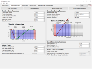

I think the main problem is that the Ultramotor is a low-pole-count DD hubmotor, relative to most hubmotors. IIRC it's only 8 poles (16 large magnets) vs common DD hubs that have 23 poles (46 magnets). Big difference for the amount of signals per degree of rotation the controller can get as feedback from the rotor....
I've recently had a motor cable damage issue that killed one hall in the leftside Ultramotor on SB Cruiser. Repairing the hall requires unlacing half the wheel to pull an Ultramotor apart, so...I'd rather avoid this until I don't have a choice. ;)
Also, I don't know if the controller's hall input was damaged by the phase wire short; still have to test for that. If it was, then I *have* to run sensorless-only, and I really need to fix the behavior via teh controller settings, or else I have to replace the PRv1(?) with a generic type that doesn't do the FOC or the strong regen, etc. (like the old Grinfineon I used to use on that side, still mounted under the trike as a backup, IIRC).
I already had sensorless fallback mode enabled, so it still worked, but was very jerky trying to startup before it figured out the halls weren't working every single start from a stop. (of which I have more than a few on my daily commute). Aside from being painful and annoying to be shaken back and forth this hard, repeatedly, it's hard on the axle and dropouts.
Works fine once it's moving, until I slow down to a stop or near stop, at which point it constantly jerks back and forth again.
Easy to work around using Sensorless mode...except that this has the same problem trying to startup, and if I drop back to a low enough speed (don't know exactly how low, but in the 1mph or less range, speedometer not accurate that low).

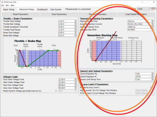

I've poked around the Phaserunner Setup Suite and didn't see anything that I can tell for sure would change this behavior without screwing up normal behavior, and don't know which ones I might experiment with safely to try different things, most expecially without damaging the controller itself.
There is a section just for Sensorless Startup, and I could reduce the amps from the IIRC 45A there to something much smaller whcih should reduce it's ability to jerk the trike around, since the rightside wheel still has plenty of startup power to get it going the first tiny bit that lets the left one get into the sensorless-running-fine speed range.
But I don't know for sure that's what this setting means....
So...any ideas are appreciated; the more specific, the better.

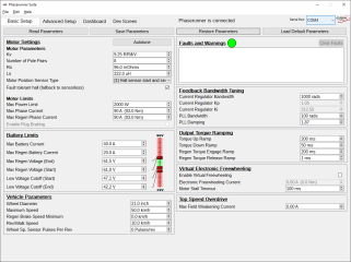

Amberwolf, what do your Motor Settings look like? Specifically these options...
I'm curious about the Fault tolerant hall because of the description.....
Can you share a screeny of your Basic and Advanced tabs?
Hey Neptronix, the more you mention VESC, the more I want to try it. My buddy has a front motor that he is willing to give me, so I'm scoping out Spintend and other VESC to go dual motor at roughly 600W each. With a VESC, I can keep the VESC inside the bike frame. I still need to look at what regen with 2 motors would be like. I'll comb Amberwolfs trike, and other, build threads to get more ideas.
As noted in the first post in the thread, I had Fault Tolerant hall enabled, but that setting is now irrelevant because I have set Sensorless mode in Motor Position Sensor Type just above that, since I already know the halls won't work. ;)
It has the same jerky startup problem regardless of MPST setting, because of the broken hall, so it always has to work sensorless anyway.
If FTH is not enabled, and it's not set to sensorless, it will not operate the motor beyond a quick attempt because it isn't getting the third hall signal.
In the interest of knowledge, these are the settings last programmed in (except for the MPST sensorless setting):
There's nothing in there that I would change, because the motor operates perfectly fine other than at startup, and *only* because of the sensorless issue. I don't want to change the operation of the system when it's actually spinning normally.
I would only want to change settings specific to the sensorless startup section, which I have a screenshot of at the first post in this thread. ;) (and is also included as the first one in the thumbnails above)

I need to find out which setting *in the PR* to change *in the sensorless startup section of the Phaserunner Setup Suite* to stop or minimize the problem.

I *only* can use a solution that will change the phaserunner's sensorless startup settings to correct or minimize the specific issue defined.

Pretty easy to wire one CA to one motor and one to the other IMO.
Why would I buy another CA and cut up my trike wiring, splice in all my stuff to that, find a place to mount it, go thru all the setup for it, etc., when there is a "page" of settings just to help with the situation I have, right in the PR?
If I want to keep the broken-hall motor/controller from jerking around at startup, I can just do what I said previously, and add a button / relay for that. :(
Would probably take an hour or less even if I do it "right" instead of the 10-minute hack, and cost nothing for parts I already have laying around, vs a couple hundred dollars in parts and several hours (at least) of time (assuming nothing goes wrong and I don't break anything else in the process of rewiring the CA's, splicing things in, etc). Would be faster and much cheaper and honestly less work to unlace the motor, open it, and replace the hall.
If I could just get replies that actually discuss the "page" of settings right in the Phaserunner Setup Suite just to help with the situation I have, as a solution, it would be helpful. :/
