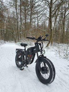

Hello,

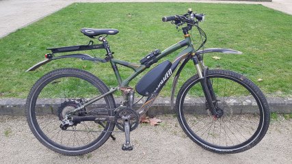

I've been enjoying riding a 29" Specialized Stumpjumper with a 750W GoSwiss Drive for 10 years. Before inserting the engine, I really enjoyed the bike as well. It's been a great project, and the built-in torque sensor was taken for granted for a long time in simple, enjoyable commutes as well as forest rides.
I wanted to get a more comfortable low-rider, and got a 20" Chinese fatbike to convert. I want to have a bike that can do 65 km/h, pedal comfortably and respond well to the applied torque. I knew I wasn't going to get that off Amazon, but the product as it is currently is really something to cry about, a poor scooter instead of a powerful bicycle. Some people do not understand what the potential of their product really is.
After wiping my tears, I need any kind of help finding:
- a powerful 3000 W engine that can assist with a specific power instead of a maximum speed (ideally directed by a Cycle Analyst)
- a fitting Schlumpf drive to pedal at a high speed so it doesn't feel too stupid to have pedals on it; it currently sports 46/14 sprockets on 20" wheels, that's far from feasible at high speeds
Any suggestions would be of great help.

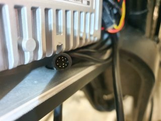

The bike currently has a Dongguan jing hui 52V brushless DC motor controller with 2x output of 25A, on 20" wheels. It's already quite nice and powerful (45-50 km/h), if only I could regulate the PAS/torque better with the CA - the controller has a weird 10-pin output (like Radwagon) and I can't find any information on how to pair that to a CA.
My hope is to achieve such speed (or almost) with a 72V 3000W rear motor; but I don't know if it's possible.
And also, I'd like it to be quiet 🤭
QS273, 175mm dropout version, which would be right around 180mm with the required washers. Speed and power shouldn't be an issue. With the CA, you can pair is with any old cheap dumb powerful 72V controller.
Thanks, that sounds like a very nice solution! I don't see a QS273 on the Risunmotor website with a 20" wheel, but I guess it'll have to be re-spoked.
I'll check thoroughly for the controller anyways, I was already sorry to learn the CA cannot be used with my stock Rad-like 10-pins cable.
