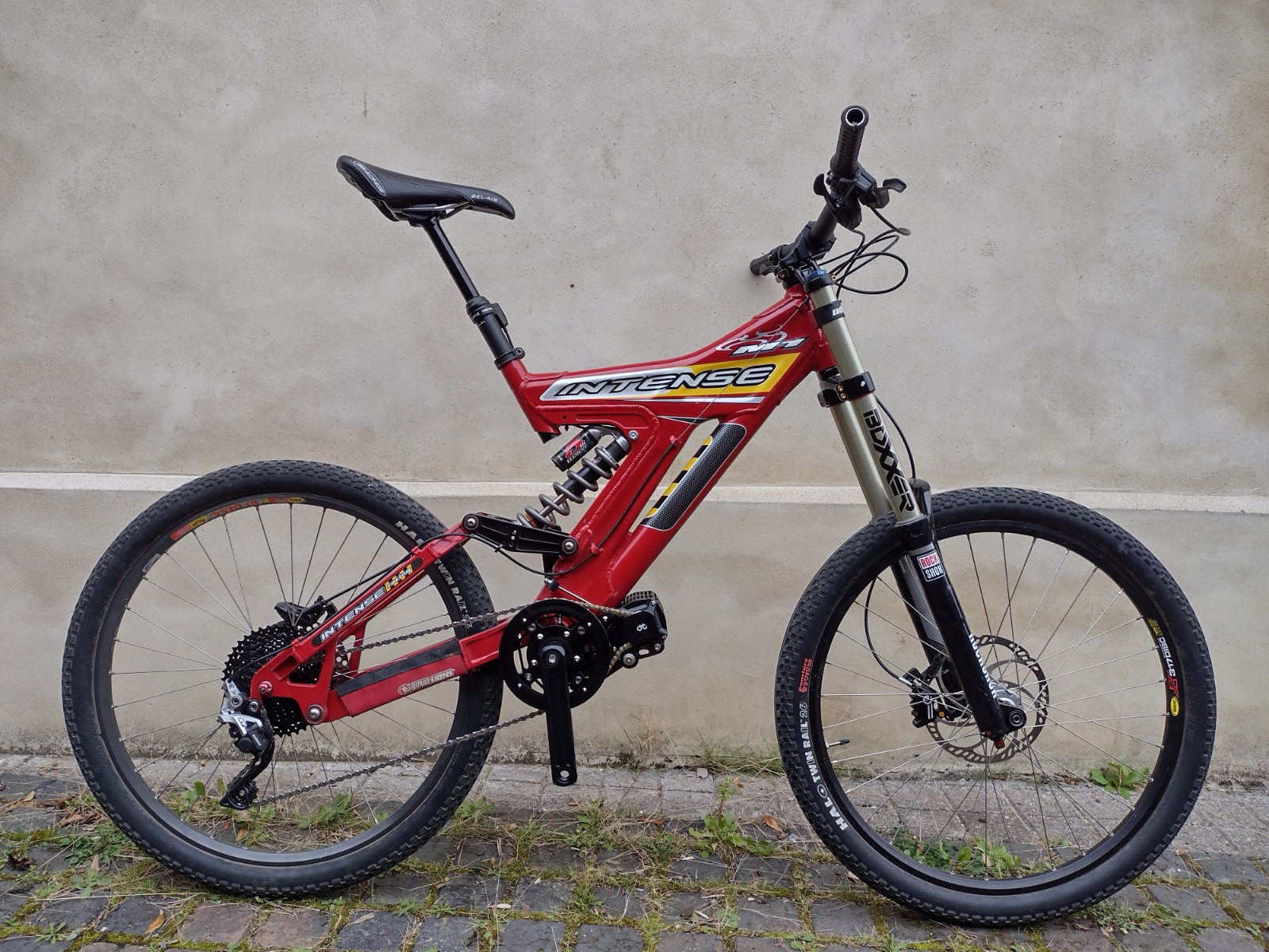

Here's mine without battery and wearing road tyres, will get an image up later with battery and knobblies.
Love the cyc so far!

Looks sweet! Where and how are you going to mount a battery on that frame?? I have similar problem on my old Stumpjumper. I tried it under the downtube with some rivnuts and wasn't totally happy with that. I also have another cable that I can switch to a battery in my backpack. My next plan is to use one of those clamp on rear racks to mount my super shark battery pack. Rack has 22 pound limit, battery weighs about 8 IIRC. But I'd use that only for road rides where the forces are less. Trail rides would need the backpack battery.

Thanks:)
full
We had a good measure up with the fork spring out and made a custom 21700 3/14 pack with bms. It's a duct tape and zip tie test installation at moment so next job is to make a proper battery box.
Only really needed power level two at most on the trails, it's really got some pace. Level five wants to power wheelie and flip me :shock: :lol:
That's where I have the shark pack mount on my Stumpy... held on with rivnuts. I also add some velcro straps to help secure it. But I still don't trust it for serious MTB trail use. Duct tape sure will hold it, though. As for pace, yes. On trails with my X1 Pro level 1 or 2 only. On the road the sky's the limit! :)
I'm amazed how good these motors are off road, we're having a blast. And the power available is just outrageous!
Belting around on a dh bike like it's a 20lb xc bike is hilarious:)
