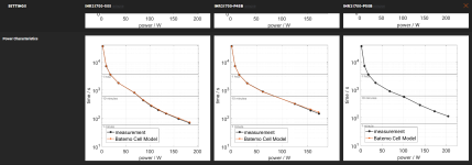

As for the Molicel P50B, I was little confused for a while, but then I took a look if there is available datasheet. I only found some printsreen version on Aliexpress, where one graph actually confirms my results. There is a claim that without active cooling at 23°C ambient temperature and 100% DoD discharge, this cell can handle only about 30A @ 6C within the 80°C cut-off limit.
If I were to add a conclusion, it would be the idea that it seems that the tab-design limits small cylindrical formats (18650 and 21700) to about 30 A continuous. If we want to go further, it will be very difficult to do it without using tabless design.
