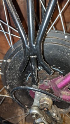

P2: Made some torque arms for the bike. I started by designing in Autodesk Fusion 360, then 3d printing them at a local makerspace out of PLA plastic to test fit them.
This is a more final design, but you can see where I've marked fitment issues with the derailleur and frame. This was my first time using CAD for a project where I actually had some creative freedom, so it was a real learning curve (it still is).
I also bought tires, Maxxis Hookworm 27.5 x2.5 slicks. Madison gets lots of ice and salt on the roads in the winter, so over Thanksgiving or winter break I'll order some Schwalbe studded tires and swap them over.
With lots of help from the makerspace's resident engineer, I finalized my design in CAD.
Some more info on the design:
Left & right have different designs (accomodating derailleur on right, extra bracket on left).
Both are 30.75mm wide, 15.75mm wide section of metal locates the axle up/down & front/back, connecting to a 70mm long 15mm wide stem that is anchored to the frame via hose clamps. At the time of this writing, I am considering upgrading to U bolts and/or utilizing the bracket on the left side of the frame to better anchor the torque arms.
I made the torque arms out of some aluminum stock lying around. No clue what alloy, if someone else knows I'd love to find out just to have that knowledge.
This was my first time ever using a CNC mill, so the engineer there had to design my tool paths and work the mill for me. I know I have my whole life ahead of me to learn how to use all these tools but I really can't wait to get better.
Here's the finished product; it was necessary to hand mill back side of the stem off because it would have interfered with the frame, and flipping the part over to CNC mill it would probably have been a waste of time. Obviously, some hand filing was needed to finish it all up.
This is what the bike looked like with torque arms installed. Note the lack of a rear brake (only running regen back there) and at this point the lack of a front caliper. I spent some time figuring out the right ebrake lever for my bike's controller and mineral oil brakes, only to discover that I would have to make my own. For the first week or so of this bike running, I ran it at the lowest setting (under 15mph) and could only stop via regen or shoes to the asphalt. Suffice it to say, wouldn't recommend.

^This. Regen is great. Definitely need a torque arm. I have the V7 Regen TA from Grin. It is expensive, but it’s better than rebuilding your bike after the dropouts fail from the unrelenting twisting force of a Regen capable motor.

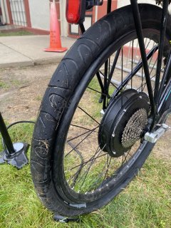

A few days after I got my brakes working, I discovered a leak in my tire.
This was the first day of class, and it was hard to see this bike as the reliable commuter I had pitched to myself and others.

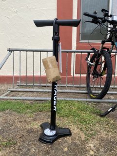

Upon trying to reinflate it with my dad's old dept. store bike pump, the old pump's seal gave up the ghost. It was an old Target or Dick's no name pump, not exactly serviceable; more to the point, I needed a new and better pump ASAP, so I went on foot to the local bike shop to get a pump, a Bontrager Charger floor pump.
I discovered the tire wasn't able to hold air for more than 15 minutes, so I went to class and resolved to fix it later. After class, I splashed soapy water on the tire (and made a mental note to buy an empty spray bottle to use for things like this later) and found no visible leak. At that time I (incorrectly) assumed it was a leak from the valve. I went to my local bike shop and bought a Schwalbe seamless tire tube, and installed it on my bike.
Of course, I didn't do it perfectly the first time:
I installed it correctly and then went along my merry way.

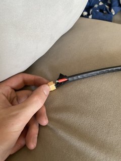

After all that battery fun, I was promptly rewarded by my battery's connector popping.
I did an ok job melting down the big blob of solder and getting the wire to reconnect with the connector, but that lasted a whole 5 minutes and blew on my way home. I went back to the makerspace and actually did it the right way, inspecting the wires and soldering joints more closely after I was done. Now it's held up for a couple of months.

The Grin V7 is also made of stainless steel though. Should I put zinc-plated mild steel washers in between the torque arms and the frame then, or something else? Or is a stainless steel axle not a viable choice for me?
The arm itself does not attach to the frame. Rather there is an intermediary 'foot' that attaches to the end of the arm and presses against the frame. The two are attached by a bolt and nut to permit removing the wheel with the arm from the bicycle without also releasing the frame attachment.
While I have one of these, it's packed away. This foot may not be stainless steel, but rather aluminium. In this case, the attaching bolt could be zinc plated to avoid the problem.
If the foot itself is stainless steel, then the paint on the frame could be sufficient.

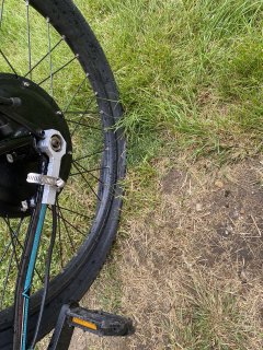

Why is the hose clamp closer to the middle instead of the end of the arm where it's most effective?

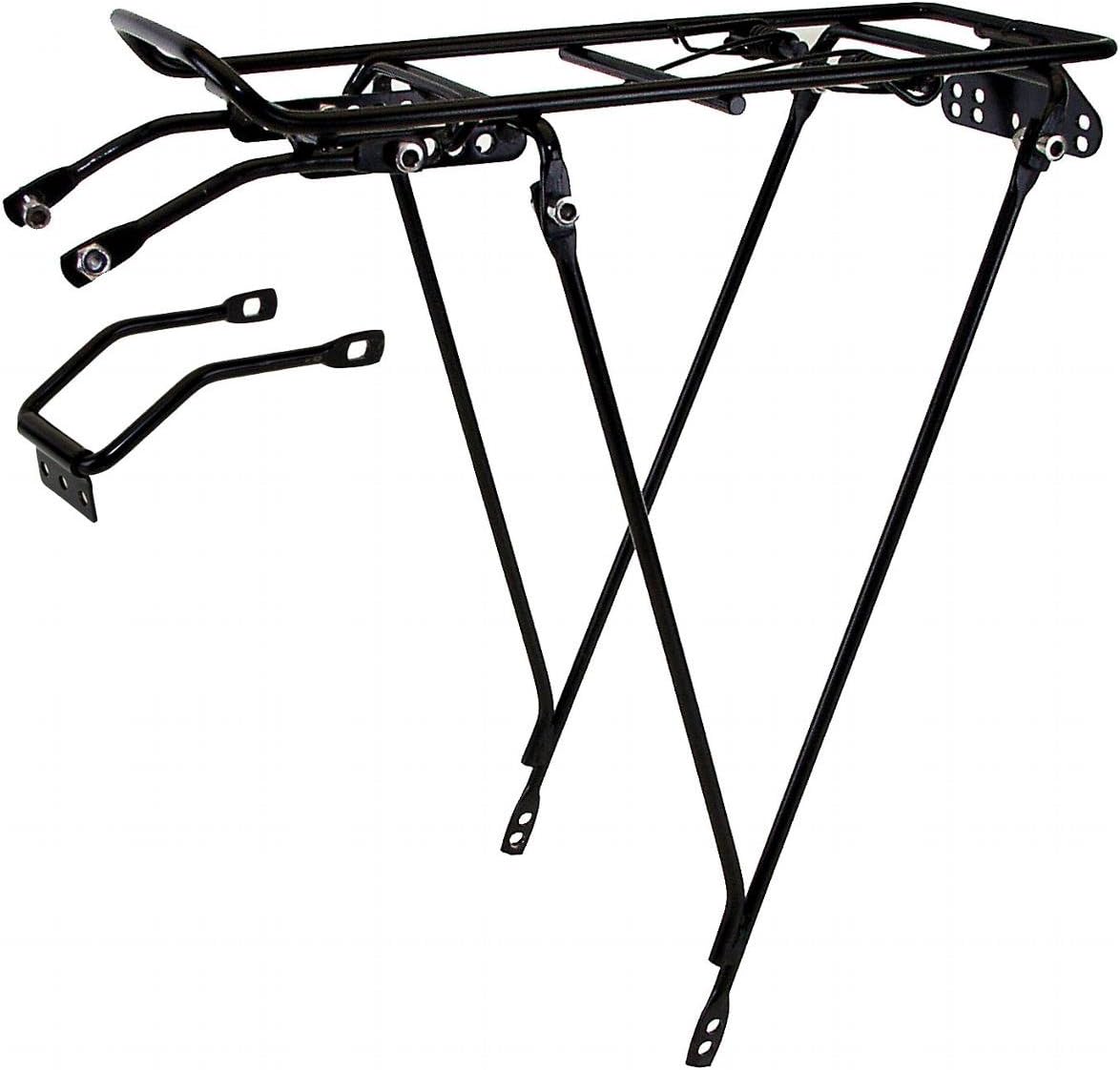

A word of caution on the rack support. Mine broke after the first year or so. It carries just the battery (14s5p). I sleeved each of the main support tubes inside with a solid aluminum shaft potted in epoxy. Been good so fr (3 years).
There aren’t many racks that hold up with e-bikes, especially on rough roads or trails. After destroying a couple, I ended up redoing and rearranging the supports to increase strength where the failures occurred. So far, so good.
Agreed! That's why I'm amazed at this spindly rack on my daily cruiser has held up for 10,000 miles and going strong. It has not only a 14s6p pack on it but all my tire repair/tool stuff and saddle bags that I load clothes and groceries. It's steel where everything else seems to be aluminum.
Poor judgement, now the U bolts are as far out as possible (will post pics in the later parts of build thread).
